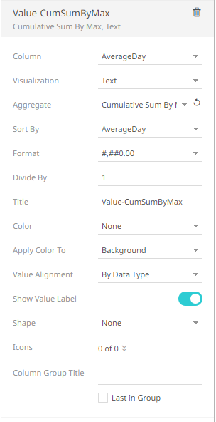

Provide a weight column that when summed gives the order of the nodes. For example, create a new calculated column based on this expression:
AverageDay = [Day]/[RowsPerDay]
Make Value-CumSumByMax as the new aggregate column (CumulativeSumByMax) based on Value as the source column and AverageDay as the weight column.
The Date – Day column serves as the breakdown.
