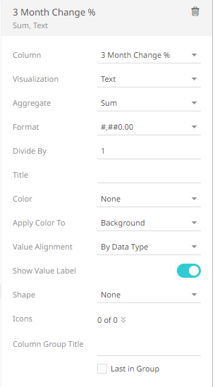

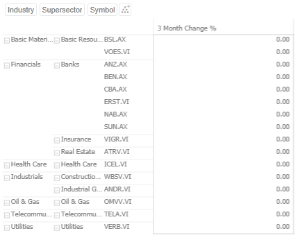

This Table visualization is showing the grouping of the columns based on the breakdown hierarchy with 3 Month Change %’s aggregate set to Sum.
Changing the aggregate to Level and the format to #,##0.00 will produce this table since the Visible Depth is set until Symbol:

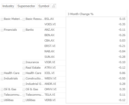

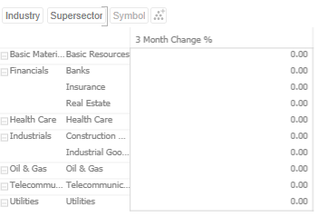

Clicking on Supersector will make the Symbol breakdown column invisible:
Sample 3

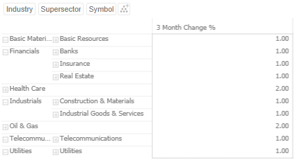

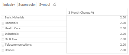

Collapsing columns in the table can also change the Level values:
Sample 4
Clicking to the Root in the breakdown hierarchy:

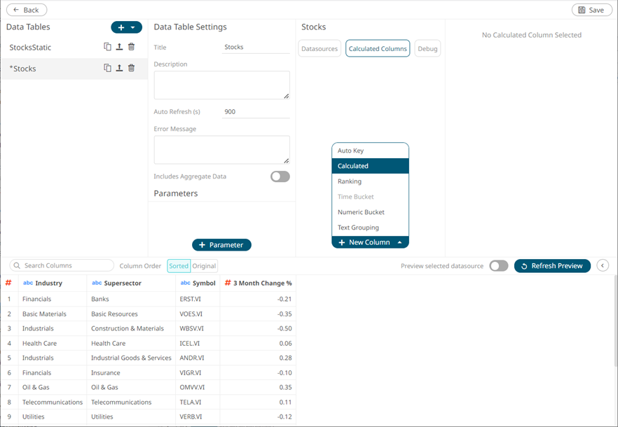

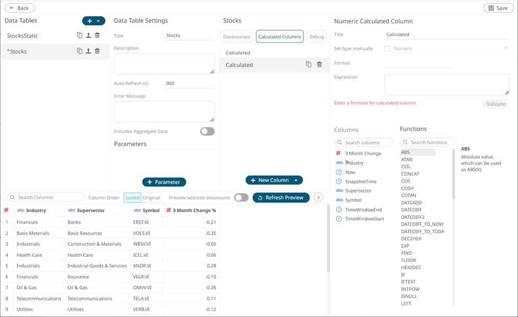

The Level aggregate can also be used when creating calculated columns.

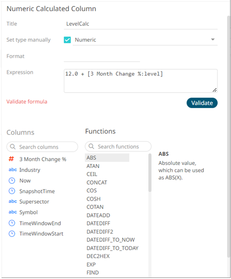

1.     On the Data Table Editor layout page, click Calculated Columns and select Calculated.
The Numeric Calculated Column pane displays.
2.     Build the expression with the Level aggregate.
For example: 12.0 + [3 Month Change %:level]

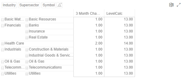

When all of the levels are visible in the breakdown (Sample 1), the results will be:
Industry
Supersector
Symbol
3 Month Change %
LevelCalc
Basic Materials
Basic Resources
BSL.AX
0
12.0
VOES.VI
0
12.0
Financials
Banks
ANZ.AX
0
12.0
BEN.AX
0
12.0
CBA.AX
0
12.0
ERST.VI
0
12.0
NAB.AX
0
12.0
SUN.AX
0
12.0
Insurance
VIGR.VI
0
12.0
Real Estate
ATRV.VI
0
12.0
Health Care
Health Care
ICEL.VI
0
12.0
Industrials
Construction & Materials
WBSV.VI
0
12.0
Industrial Goods & Services
ANDR.VI
0
12.0
Oil & Gas
Oil & Gas
OMVV.VI
0
12.0
Telecommunications
Telecommunications
TELA.VI
0
12.0
Utilities
Utilities
VERB.VI
0
12.0
Collapsing columns in the table (similar with Sample 3 above) will result to:
