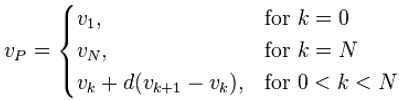

Percentile  is the value of the P-th percentile of an ascending ordered data set containing N elements with values .
There are two steps to compute for Percentile.
1.     Calculate the rank:
The rank is then split into its integer component k and decimal component d, such that ..
2.     Use the formula below to calculate  as:

Consider the ordered list of values 15, 20, 35, 40, 50. What is the 40th percentile of this list?
1.     Calculate the rank of the 40th percentile as follows.
Thus, n=2.6, which gives us k=2 and d=0.6.
2.     Calculate the value of the 40th percentile.
Thus, the value of the 40th percentile of the ordered list 15, 20, 35, 40, 50 is 29.
Sample 2
Consider the ordered list 1,2,3,4. What is the 75th percentile of this list?
1.     Calculate the rank of the 75th percentile as follows.
N = 75/100(4-1) + 1 = 3.25
Thus, n=3.25, which gives us k=3 and d=0.25.
2.     Calculate the value of the 75th percentile.
Thus, the value of the 75th percentile of the ordered list 1,2,3,4 is 3.25.
