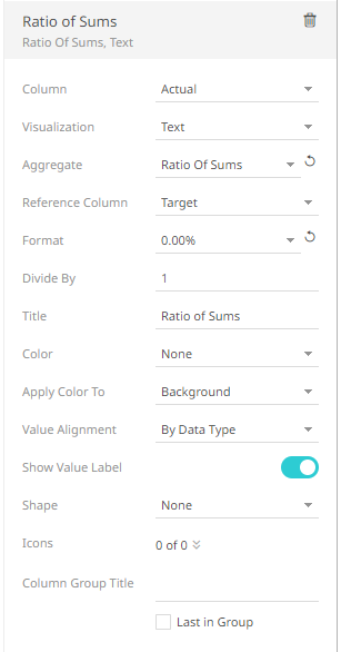

Setting the Column to Actual and the Reference Column to Target with the format set to 0.00% results to the following Ratio of Sums values:
