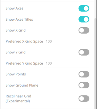

The 3D surface plot settings pane is displayed after clicking the Options  button.
Setting
Show Axes
Determines whether axes are displayed.
Show Axes Titles
Determines whether axes titles are displayed.
Show X Grid
Determines whether the X Grid lines are displayed and if checked the space in pixels between them.
Preferred X Grid Space
Specifies the X Grid lines spacing. Default is 100.
Show Y Grid
Determines whether the Y Grid lines are displayed and if checked the space in pixels between them.
Preferred Y Grid Space
Specifies the Y Grid lines spacing. Default is 100.
Show Points
Determines whether markers are drawn over surface data points.
Show Ground Plane
Determines whether a ground plane should be drawn below the 3D surface
Rectilinear Grid
Determines whether distinct X and Y values are changed into a rectilinear grid where missing values are filled in with a default of zero (or the ground level).
