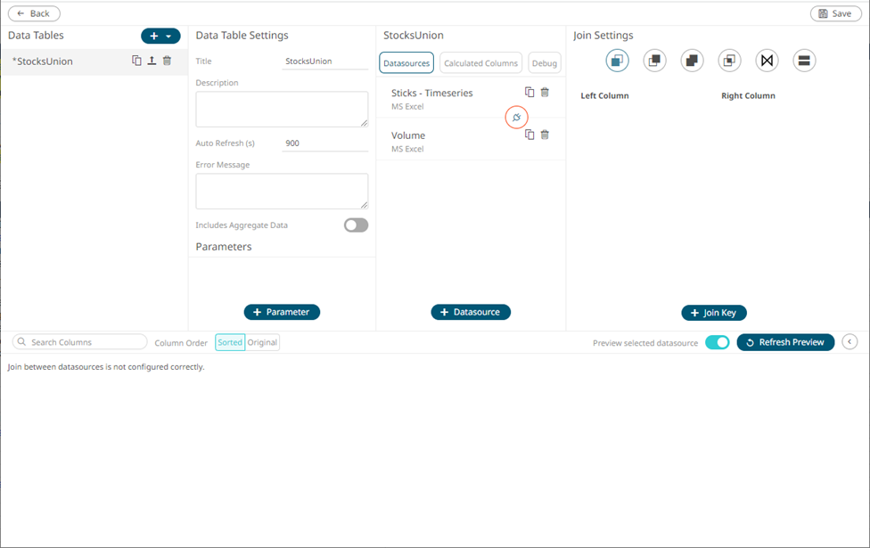

1.     To join the data sources, click the Join  button.
The Join Settings pane displays.

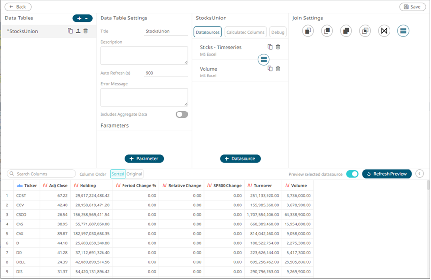

2.     Select Union All then click .
The result of the union all is displayed in the Data Source Preview.
3.     Click . Once saved, a notification displays.
