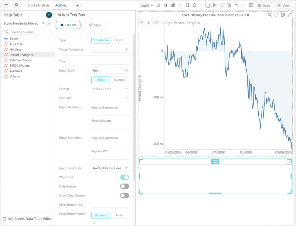

1.     After double-clicking or drawing a rectangle on the dashboard canvas, click  on the Select Part pane then click the Action Text Box  icon.
The Action Text Box pane is displayed, and the Action Text Box part is added on the dashboard canvas.
For this example, the following parameters are defined:
Parameter Name
Type
Default Value
Ticker
Text
COST
Slider Value
Text
0
These parameters are used on the Title of the Line graph (e.g., Price History for {Ticker} with Slider Value = {Slider Value:0.00%}).

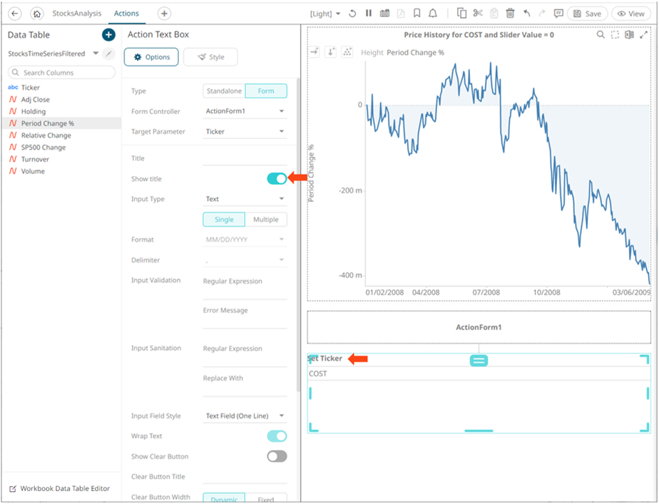

2.     The action text box can be configured to either be a Standalone or a Form component.
When set to Form, the action text box can be connected to any form controller on the same dashboard. The parameters that the action part can set depends on how the form is configured.
   NOTE
An action form part must be defined first to associate the action text box as a component. Refer to Adding an Action Form more information.
A line connects the component to the associated form. By default, the Show Title slider is turned on and the title is displayed to describe what parameter the text box is setting (e.g., Set Ticker). Tap to slider to turn it off.

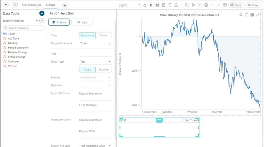

If the action text box should not be connected to a form, it can be set to Standalone instead. Select the Target Parameter that will be updated by this action part.
3.     Enter the Title of the text box.
If set to the Standalone type and the Title is blank, the button will be Set <Target Parameter>.

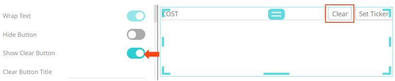

11.     Tap the Show Clear Button slider to display a button that will clear the text box when clicked.
12.     Enter the Clear Button Title, if required.

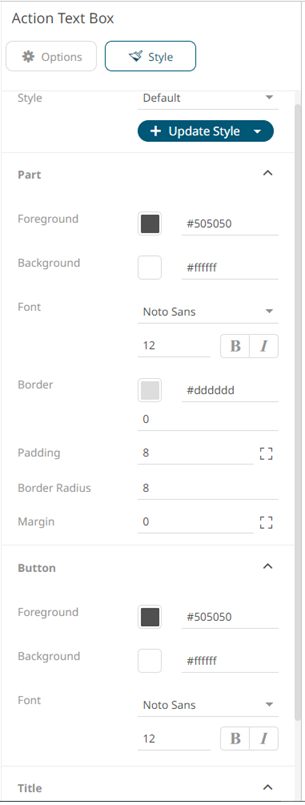

17.     To set the style of the Action Text Box, click Style .
The page updates to display the Style pane.
See Defining the Style of General Parts for more information.

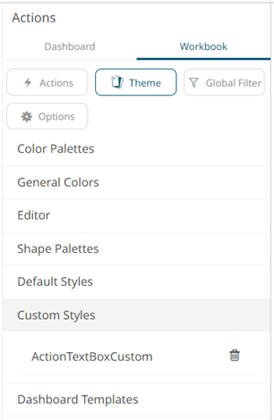

The new custom style is added in the Workbook > Theme > Custom Styles list.
If published, the custom style configuration of the Action Text Box will be added to the Global custom styles list and can be applied to other parts.
