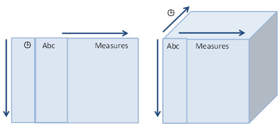

Your source data must be transformed to use time series visualization. The transform converts the dataset into a cube, where the Z axis of the cube represents time, providing a set of time slices to play through and calculate across.
When there is a time slice, but not a value determined by the selected dimensions, the value will be set to null, and in the case of a line graph, a gap in the line will be drawn.
The time slices of the output time series can be identical to the input dataset, or as typically the case with sensor data will be standardized by barring (conflating) into an appropriate granularity for display.

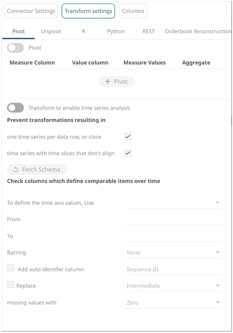

1.     Click on a data source on the Data Sources pane. The currently selected data source is highlighted (grey background).
The corresponding Data Source Settings pane displays.

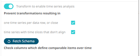

2.     Click the Transform Settings button. The Transform Settings pane displays.
3.     Tap the Transform to enable Time Series analysis slider to turn it on.
   NOTE
Once enabled, the Transform Settings button displays with a check . If the transform leads to change in the schema, the Fetch Schema  button is also enabled.
The check boxes for: one time series per data row, or close and time series with time slices that don’t align, ensure that duplicate values are highlighted, and the time cube volume is minimized.
4.     Click Fetch Schema to update columns available for time series transform.
5.     Select the key or compound key columns from the source list of dimensions to define comparable items over time.
These define each series and correspond to the rows of the generated time cube.
6.     Select the column to define the time axis values (Date/Time stamp).
Default value is Date.
7.     Set the Date/Time range of the column set in step 5 in the From and To text boxes.

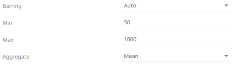

8.     Choose whether you want to Conflate the dataset by setting the Barring period to Auto, or a defined value, between Year and Nanosecond.
Setting the barring period conflates the dataset to a defined granularity, returning a set number of data points, by default being between 50 and 1000 for Auto.
As data is potentially being aggregated across time, an Aggregate must be selected.  The default conflation aggregate is Mean. Other options include: Sum, Min, Max, First,  Last and Count.

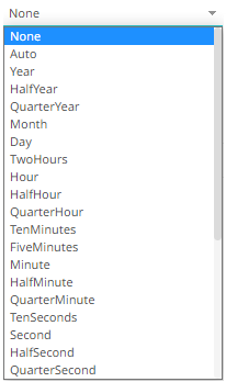

The available barring periods besides Auto are:
Year, Half Year, Quarter Year, Month, Day, Two Hours, Hour, Half Hour, Quarter Hour, Ten Minutes, Five Minutes, Minute, Half Minute, Quarter Minute, Ten Seconds, Second, Half Second, Quarter Second, Tenth Second, Fifty Milliseconds, Ten Milliseconds, Five Milliseconds, Millisecond, Fifty Microseconds, Ten Microseconds, Five Microseconds, Microsecond, Fifty Nanoseconds, Ten Nanoseconds, Five Nanoseconds, Nanosecond.

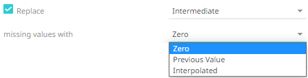

9.     Choose whether you want to interpolate for missing values.
The interpolation can replace missing numeric values with Zero, the Previous Value, or an interpolation between known values (Interpolated).

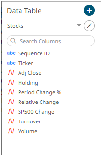

11.     Click  then  to save the data table and exit the Data Table Editor  layout. On the Open Workbook in Design Mode, a time series data table is visually identified by the time series curve to the left of any numeric time series fields.
