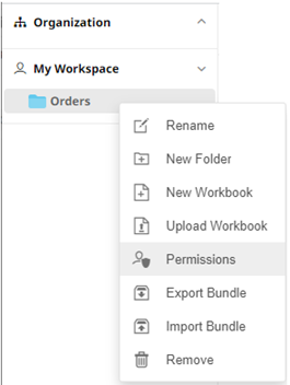

1.     Right-click on a folder and select Permissions in the context menu.

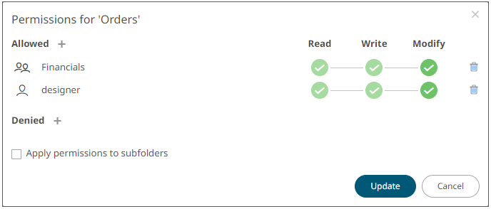

The Permissions dialog displays.
2.     Under the Denied section, click the Add  icon.

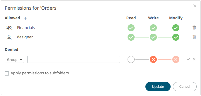

A new User/Group Denied section is displayed.
3.     Select User or Group that will be given denied permission in the drop-down list.

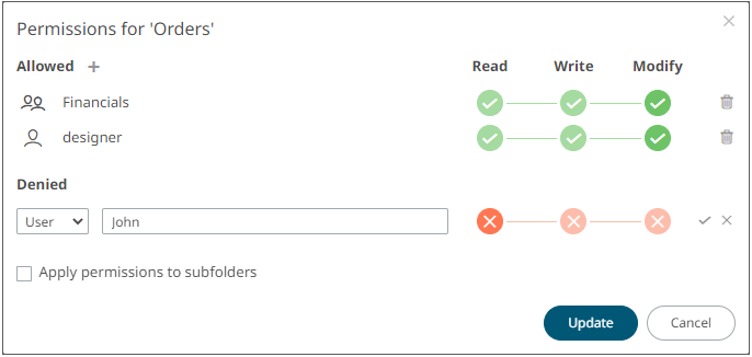

4.     Enter the user or group Name.
5.     Select the denied permission level that will be grated to the user or group:
·         MODIFY
Prevent user or group to modify and create subfolders.
·         WRITE + MODIFY
Prevent user or group to modify and write to the folder.
·         READ + WRITE + MODIFY
Prevent user or group to modify and create subfolders, modify and write to the folder, as well as read the folder.
6.     Click . The user or group is added under the Denied list.
