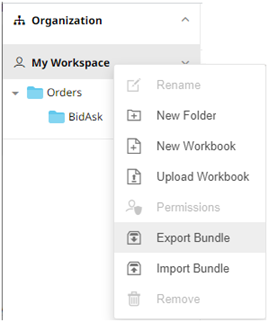

1.     Right-click on a workbook or folder and select Export Bundle in the context menu.
Workbook Folder or Subfolder Context Menu
Workbook Context Menu

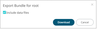

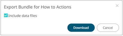

A notification message displays.
The Include Data Files box is checked by default. This means the associated workbook data files will be included in the download.
2.     Click . A copy of the workbook or folder bundle is downloaded.
