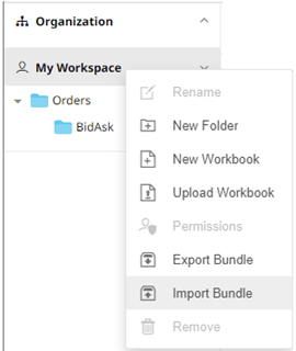

1.     Right-click on a folder and select Import Bundle in the context menu.
The Import Bundle dialog displays.

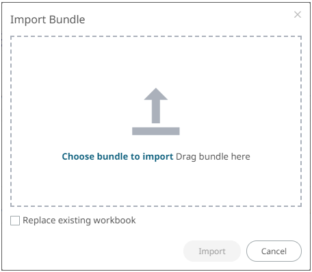

2.     To import a bundle, you can either:
·         Drag it from your desktop and drop on the dialog, or
·         Click Choose Bundle to Import and select one on the Open dialog that displays.

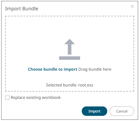

The name of the selected bundle is displayed on the dialog box.
3.     To replace existing workbooks, check the Replace existing workbook box. .
4.     Click .
