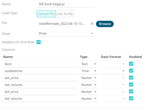

1.     Select the MS Excel File Source.
2.     Select the number of rows that will be skipped in the Excel file from the Skip First n Rows drop-down list.
3.     If the MS Excel file is password-protected, enter the File Password.
Check the Show Characters box to display the entered password characters.
   NOTE
The password is case-sensitive.
Otherwise, proceed to step 6.
4.     Click . This updates the Sheet drop-down list box and the Upgrade to MS Excel (xlsx)   button is enabled if the selected file is XLSX.
5.     You can either:
·         select the required sheet then proceed to step 8 or
·       click  to upgrade XLSX  data source to MS Excel (xlsx).
Once upgraded, the first available sheet will be automatically selected, and the columns will be populated.
