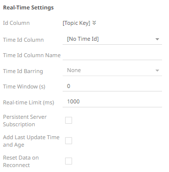

10.   For this section:
Refer to Define Real-Time Settings for more information.
