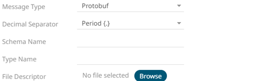

Aside from the JSON, Text, and XML message types, Protobuf and SDTMap are also supported in Solace.
If Protobuf is selected, confirm the Decimal Separator, and enter the Schema Name and Type Name.
Then click  to select the File Descriptor (.desc file) in the Open dialog.
Property
Schema Name
The Protobuf schema.
Type Name
The message of Protobuf type that will be sent to Kafka.
File Descriptor
The FileDescriptorSet which:
·         is an output of the protocol compiler.
·         represents a set of .proto files, using the --descriptor_set_out option.
