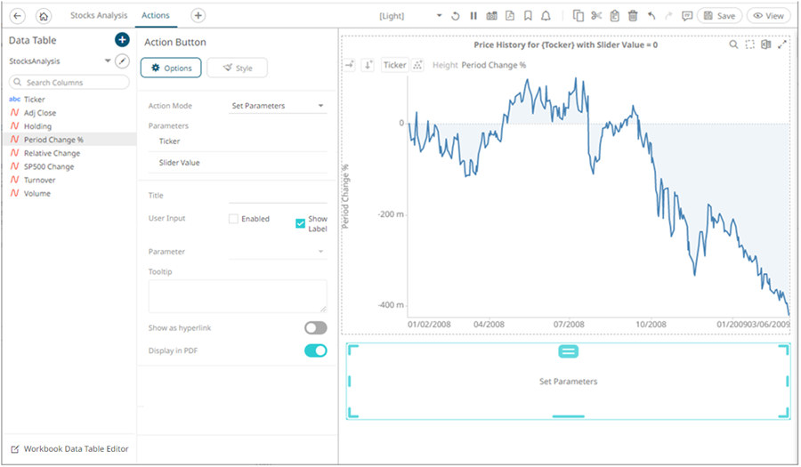

1.     After double-clicking or drawing a rectangle on the dashboard canvas, click  on the Select Part pane then click the Action Button  icon.
The Action Button pane is displayed, and the Action Button part is added on the dashboard canvas.
For this example, the following parameters are defined:
Parameter Name
Type
Default Value
Ticker
Text
COST
Slider Value
Text
0
These parameters are used on the Title of the Line graph (e.g., Price History for {Ticker} with Slider Value = {Slider Value:0.00%}).

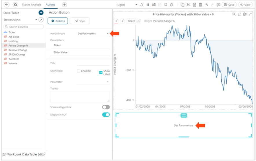

2.     Select any of the Action Modes:

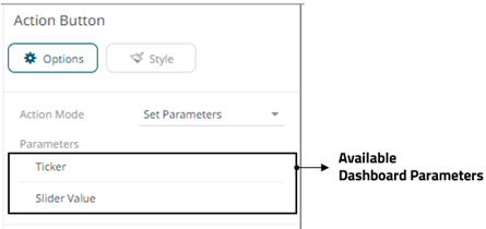

·         Set Parameters
The Parameters pane lists the available parameters to set the data loading for each interaction with the Action Button.
Click on a parameter instance to expand and set the values that the action requires.

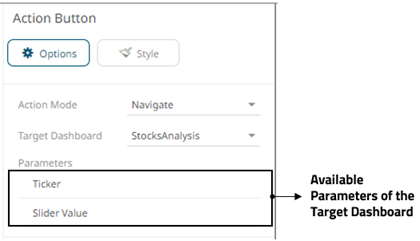

·         Navigate
Allows the selection of the dashboard where you want to pass the parameters.

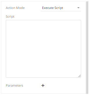

·         Execute Script
Allows the execution of a script.
Enter the parameterized Script.
The parameters are written within curly brackets, {ParameterName}.

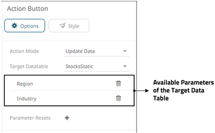

·         Update Data
Allows data update (typically in a database) by passing parameters into a data query.
Click on a parameter instance to expand and set the values that the action requires. You can also opt to click  to delete a parameter.
You can also opt to specify one or several existing parameters that will get a new value when the Update Data action is executed. You can do so by clicking   on the Parameter Resets section.
Click on the parameter instance to expand and define its properties.

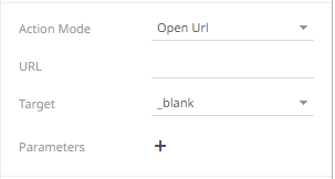

·         Open URL
Allows access to a web page or file or even point to other resources on the web such as database queries and command output.
¨        Enter the parameterized URL.
For actions allowing multiple value input, you can optionally specify a value separator within the curly brackets where you put the parameter name. The syntax is as follows:
{ParameterName:Separator}
For example: {Company:+}
Default separator is semicolon. Specifying for example a plus sign allows you to do multi search term searches on Google, for example.
At execution, the parameter will be replaced with real field values associated with the selected visualization node.
The easiest way to create parameterized URLs is to open an example web page and copy the URL. As an example, Yahoo Finance Key Statistics for Microsoft has the following web address:
http://finance.yahoo.com/q/ks?s=MSFT
If a parameter called Ticker has been set up in the data table, you can generate the URL by removing MSFT and replacing it with {Ticker}:
http://finance.yahoo.com/q/ks?s={Ticker}
¨        Select the Target area of the page where the output URL will be displayed.
¨        Click  to add parameters to the output URL.

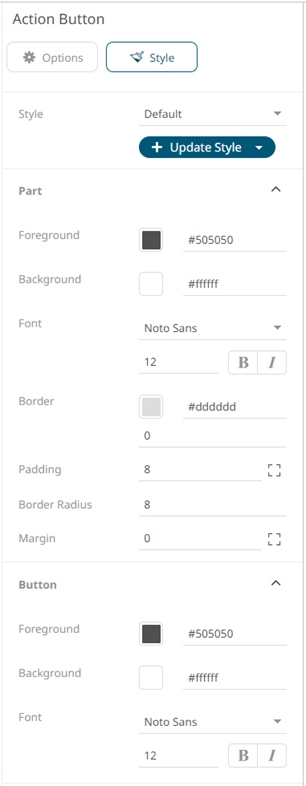

8.     To set the style of the Action Button, click Style .
The page updates to display the Style pane.
See Defining the Style of General Parts for more information.
9.     Click Update Style  and select any of the following options:
·         Set current as default – Save the changes and set it as the default.
·         Create custom style – Save the changes and set it as a custom style.
The Style pane updates to display the Title control.
¨        Enter the custom style Title.
¨        If there are additional changes made, click Update Current Style in the Update Style drop-down.

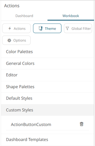

The new custom style is added in the Workbook > Theme > Custom Styles list.
If published, the custom style configuration of the Action Button will be added to the Global custom styles list and can be applied to other parts.
·         Reset to default – Revert to the original default settings.
