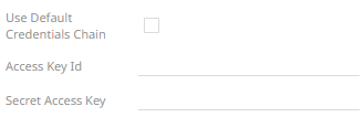

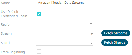

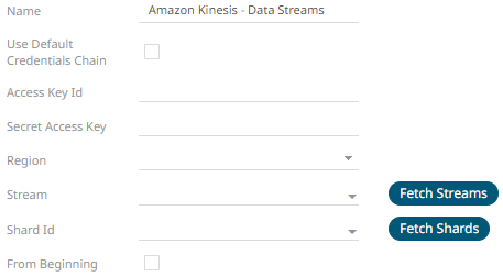

1.    Do one of the following:
·        Check the Use Default Credentials Chain box to use the default Access Key ID and Secret Key Access, or
·         Uncheck the Use Default Credentials Chain box and enter the Access Key ID and Secret Key Access.
   NOTE
The Access Key ID and Secret Key Access from the AWS account can be configured in three places:
·         Two properties at the Panopticon.properties file which is available in the AppData folder of Panopticon Real Time
o     connector.kinesis.datastreams.accesskeyid
o     connector.kinesis.datastreams.secretaccesskey
If this configuration is used, the Use Default Credentials Chain box is not displayed in the connector UI.
This is the recommended way to provide the credentials.
·         AWS credentials provider chain
o     Environment Variables - AWS_ACCESS_KEY_ID and AWS_SECRET_ACCESS_KEY
o     Credential profiles file at the default location - ~/.aws/credentials on Linux, macOS, or Unix, and C:\Users\USERNAME\.aws\credentials on Windows.
·         Dedicated fields in the connector
Not the recommended configuration.

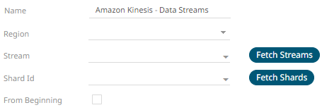

2.     Select or define the following properties:
Property
Region
Physical location of the data center. The list is picked up from the Amazon Kinesis Data Streams Endpoints and Quotas page.
Stream
Name of the stream from where you want to pull the data. Click Fetch Streams  to load all of the available streams from the AWS account.
Shard Id
Each connector instance or data source is connected to only one shard. Click Fetch Shards  to pull all of the shards from the selected stream.
From Beginning
The starting position in the data stream from which to start streaming. Default value is unchecked, which means LATEST. When checked, the starting position is set to TRIM_HORIZON.
