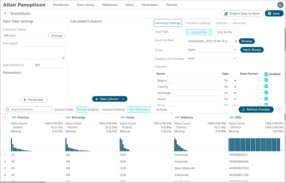

1. Select or create the data table you want to import to data store.
2. Click

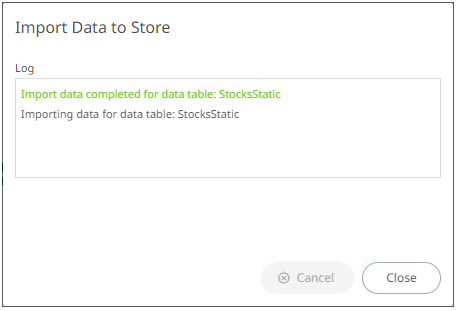

The notification dialog displays that the data table has been imported to the data store.
