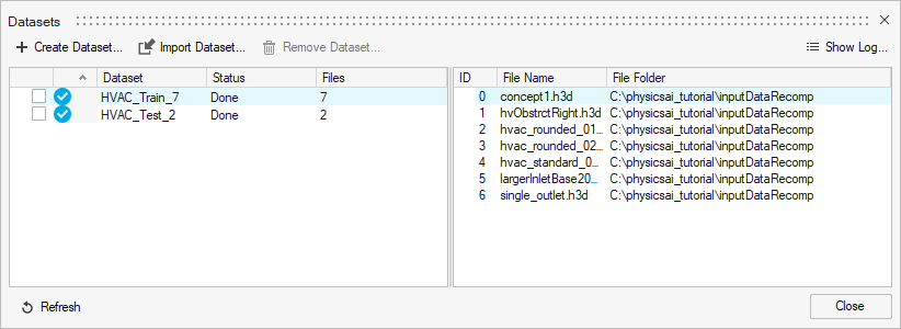

  6. Create a second dataset.
    1. Click Create Dataset to reopen the Create Dataset dialog.
    2. For name, enter HVAC_Test_2.
    3. For File System, click and navigate to the testDataRecomp folder.
    4. Select and transfer all of the .h3d files.
    5. Click OK.
      The dataset is extracted and the Datasets dialog opens.
    Figure 4.
  7. Select datasets to verify you can see the extracted datasets.
    Figure 5.
  8. Click Close.

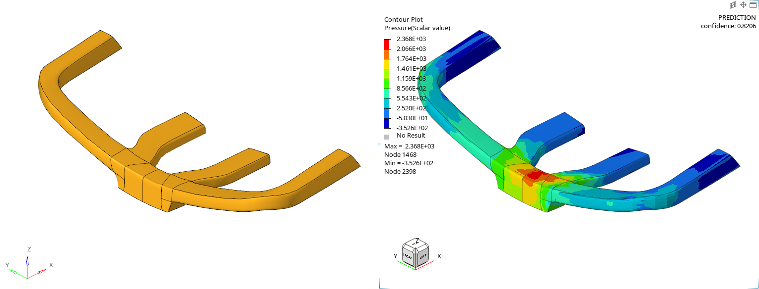

  4. From the PhysicsAI ribbon, select the Predict tool.
    Figure 12.
    Figure 13.
  5. Repeat steps 1 - 3 for the HVAC_concept2_rnd.fem file.
