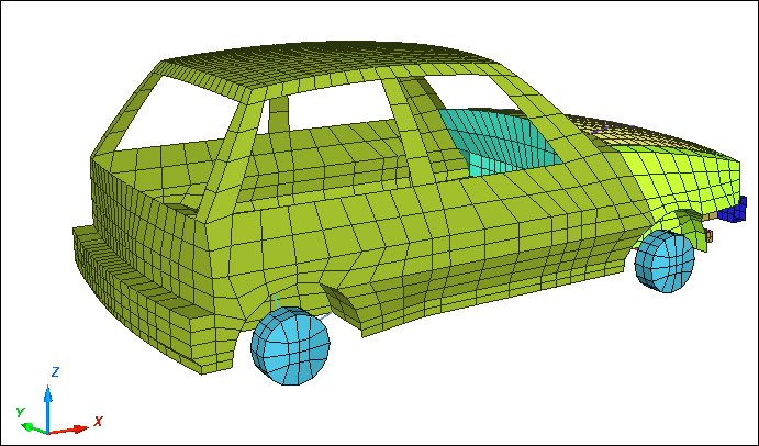

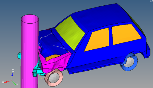

RD-T: 3050 Simplified Car Pole Impact
To simulate frontal pole test with a simplified full car.
rd3550_car
図 1.
The model description is as follows:
  • UNITS: Length (mm), Time (s), Mass (ton), Force (N) and Stress (MPa)
  • Simulation time: Engine file (_0001.rad) [0 - 0.06 ms]
  • An initial velocity of 15600 mm/s is applied on the car model to impact a rigid pole of radius 250 mm.

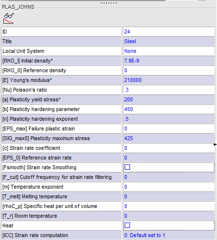

  • Elasto-plastic Material /MAT/PLAS_JOHNS (STEEL)
    [Rho_Initial] Initial Density = 7.9x10-9ton/mm3
    [E] Young's Modulus = 210000 MPa
    [nu] Poisson's Ratio = 0.3
    [ σ 0] Yield Stress = 200 MPa
    [K] Hardening Parameter = 450 MPa
    [n] Hardening Exponent = 0.5
    [SIG_max] Maximum Stress = 425 MPa

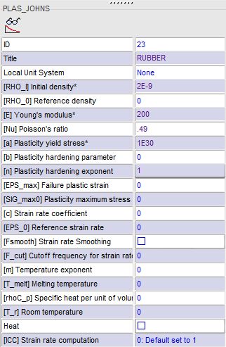

  • Elasto-plastic Material /MAT/PLAS_JOHNS (RUBBER)
    [Rho_Initial] Initial Density = 2x10-9ton/mm3
    [E] Young's Modulus = 200 MPa
    [nu] Poisson's Ratio = 0.49
    [ σ 0] Yield Stress = 1e30MPa
    [n] Hardening Exponent = 1

Create and Assign RUBBER Material
  1. In the Material list, right-click and select Create New > Elasto-plastic > Johnson-Cook (2).
  2. For Title, enter RUBBER. Enter all the material data, as shown below.
    rd3050_rubber_13
    図 3.

Create and Assign STEEL Material
  2. For Title, enter STEEL.
  3. Enter all the material data, as shown below.
    rd3050_steel_13
    図 4.
  4. Click the Tree tab and select PSHELL3, PSHELL16 and PSHELL20 to PSHELL23 in the tree.
  5. Click 06_invert to invert the tree selection.
  6. Click 06_view to show all the parts except the ones made with glass and rubber.
    rd3050_car_13
    図 5.
  7. Click the Material tab.
  8. Right-click in the Support entry box and click Selected Parts of Tree selected_part_of_tree_button.
    The selected parts will be highlighted in the modeling window.
  9. Click Save > Close.

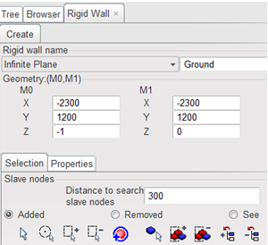

Create the Ground Rigid Wall
  1. Click LoadCase > Rigid Wall > Create.
  2. Under Rigid wall name > Select RWALL type, select Infinite Plane.
  3. Enter the rigid wall name, Ground.
  4. Enter the following values for M0 and M1:
    rd3050_ground_13
    図 6.
  5. In the Selection tab, set the Distance to search for main nodes to 300.
  6. Click See at the bottom of the panel to display the rigid wall.
  7. Click Save.

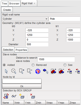

Create Pole Rigid Wall
  1. Under Rigid wall name > Select RWALL type, select Cylinder.
  2. Enter the rigid wall name, Pole.
  3. Enter the following values for M0 and M1:
    rd3050_pole_13
    図 7.
  4. Set the Diameter to 500.
  5. Set the Distance to search for main nodes to 1500.
  6. Click See at the bottom of the panel to display the rigid cylinder.
  7. Click Save.

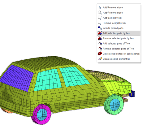

  9. In the Model Display toolbar, click Display All view_all_button to display the entire model.
  10. Click in the [Main_id] Main field. Move the cursor to the modeling window and right-click.
    The menu shown in the image below should appear.
    rd3050_add_parts
    図 8.
  11. Choose the option Add selected parts by box 05_add_parts and use the mouse to drag a box to select the entire car in the modeling window.
  12. Click Save.

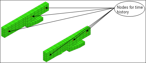

Define Time History Nodes
  1. Click Data History > Time History.
  2. In the Time History list, right-click and select Create New > TH of nodes.
  3. For Title, enter RAIL.
  4. In the Tree tab, select PSHELL19.
  5. Click Isolate Tree Selections 06_view.
  6. Go back to the Time History panel and click Add/Remove nodes by picking selection arrow_up in the second table.
    rd3050_add-remove
    図 9.
  7. Select six nodes on the rails, for example as shown in the following image:
    rd3050_data_history
    図 10.
  8. Click Yes in the lower right corner or right-click in the modeling window to exit the selection.

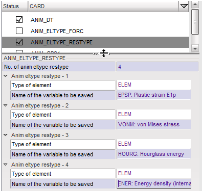

Export the Model

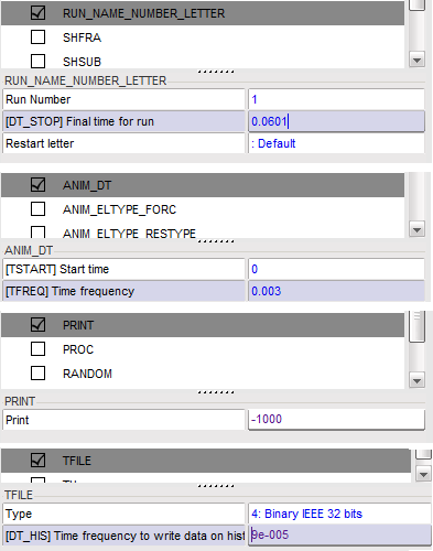

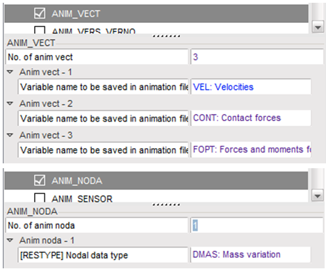

  1. To create the Engine file, from the menu bar, select Model > Control Card.
  2. Check the Control Cards, as shown in the images below.
    注: Make sure to save all control cards before editing the next.
    rd3050_control_card
    図 11.
    rd3050_control_card2
    rd3050_control_card3
    図 12.
