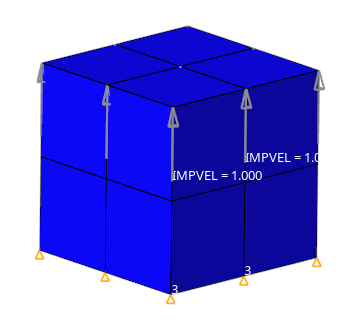

A tensile loading is applied to a cube with side lengths 25.4 mm. The bottom of the cube is fixed in the z-direction and an imposed velocity of 508 mm/s in the z direction is applied to the top of the block. The simulation was run to a final time of 0.05 seconds. A two elements per side mesh was studied.
The plastic hardening modulus, H, is used as the problem metric. In Radioss, the plastic hardening parameter, b, in /MAT/LAW2 (PLAS_JOHNS) material law is the same as the plastic hardening modulus, H.

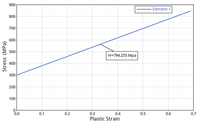

The plastic hardening modulus is the slope of the stress versus plastic strain curve.
図 2. Stress versus Plastic Strain with Hardening Modulus
Conclusion
As shown in 図 2, the hardening modulus from the simulation, H=794.255 MPa, exactly matches the value input for “b” in /MAT/LAW2 (PLAS_JOHNS).
