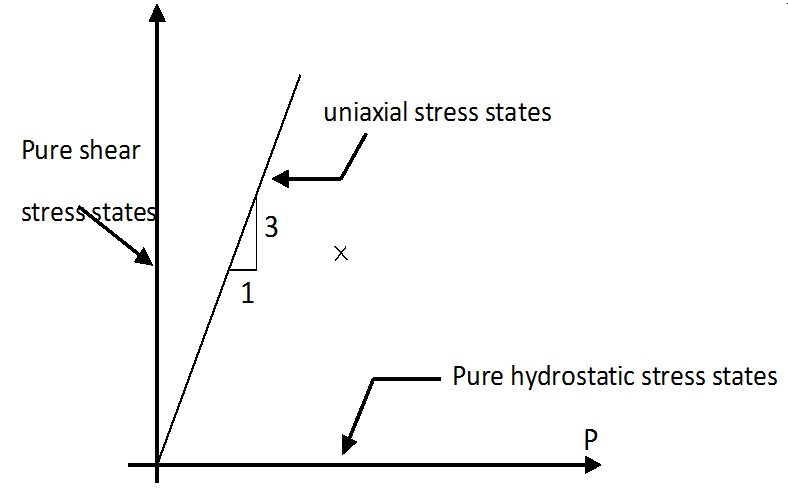

Invariant Space
図 1.
The horizontal axis corresponds to the hydrostatic loading, the vertical axes to pure shear. The line with tangent 1/3 is uniaxial compression. The line with tangent -1/3 is uniaxial tension.
