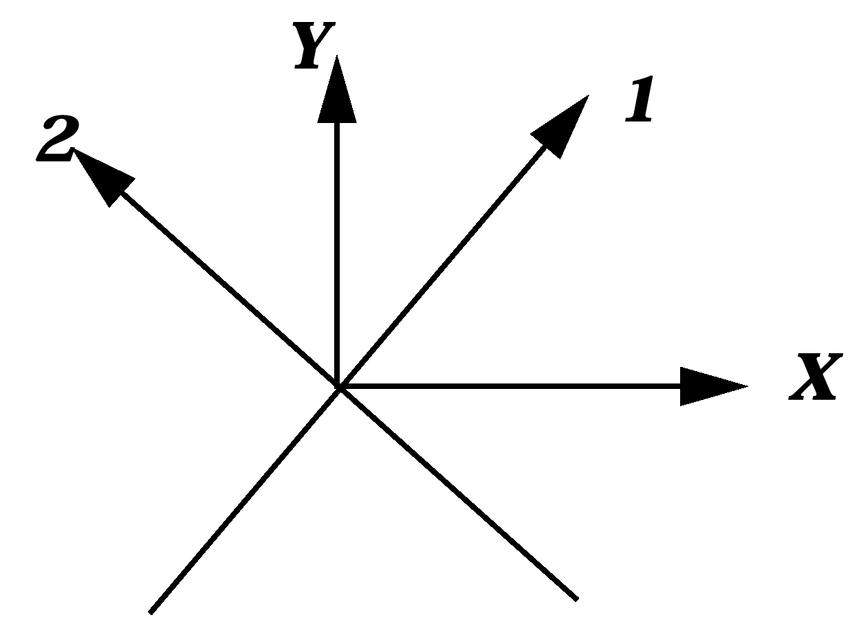

Transformation Matrix: Global to Orthotropic Skew
If the element reference is defined by the axes X, Y and the orthotropy directions by axes 1-2, write:
図 1. Fiber Orientation
[ c s s c ] with c = cos θ MathType@MTEF@5@5@+= feaagKart1ev2aaatCvAUfeBSjuyZL2yd9gzLbvyNv2CaerbwvMCKf MBHbqefqvATv2CG4uz3bIuV1wyUbqedmvETj2BSbqefm0B1jxALjhi ov2DaebbnrfifHhDYfgasaacH8srps0lbbf9q8WrFfeuY=Hhbbf9v8 qqaqFr0xc9pk0xbba9q8WqFfea0=yr0RYxir=Jbba9q8aq0=yq=He9 q8qqQ8frFve9Fve9Ff0dmeaacaGacmGadaWaaiqacaabaiaafaaake GabaaVqiaadogacqGH9aqpciGGJbGaai4BaiaacohacqaH4oqCaaa@401D@ and s = sin θ MathType@MTEF@5@5@+= feaagKart1ev2aaatCvAUfeBSjuyZL2yd9gzLbvyNv2CaerbwvMCKf MBHbqefqvATv2CG4uz3bIuV1wyUbqedmvETj2BSbqefm0B1jxALjhi ov2DaebbnrfifHhDYfgasaacH8srps0lbbf9q8WrFfeuY=Hhbbf9v8 qqaqFr0xc9pk0xbba9q8WqFfea0=yr0RYxir=Jbba9q8aq0=yq=He9 q8qqQ8frFve9Fve9Ff0dmeaacaGacmGadaWaaiqacaabaiaafaaake GabaaVqiaadohacqGH9aqpciGGZbGaaiyAaiaac6gacqaH4oqCaaa@4032@ .(1) [ ε 11 ε 12 ε 12 ε 22 ] = [ c s s c ] [ ε X ε X Y ε X Y ε Y ] [ c s s c ] (2) [ ε 11 ε 12 ε 12 ε 22 ] = [ c s s c ] [ c ε X + s . ε X Y s ε X + c . ε X Y c ε X Y + s . ε Y s ε X Y + c . ε Y ] (3) [ ε 11 ε 12 ε 12 ε 22 ] = [ c 2 ε X + 2 c s . ε X Y + s 2 . ε Y c s ε X + ( c 2 s 2 ) . ε X Y + c s . ε Y c s ε X + ( c 2 s 2 ) . ε X Y + c s . ε Y s 2 . ε X 2 c s . ε X Y + c 2 . ε Y ]
The strain-stress relation in orthotropy directions is written as:(4) { σ } = [ C ] { ε } (5) [ C ] 1 = [ 1 E 11 ν 21 E 22 0 ν 12 E 11 1 E 22 0 0 0 1 G 12 ] (6) σ = σ 11 σ 22 σ 12 ; ε = ε 11 ε 22 ε 12
The computed stresses are then projected to the element reference:(7) [ σ X X σ X Y σ X Y σ Y Y ] = [ c s s c ] [ σ 11 σ 12 σ 12 σ 22 ] [ c s s c ]

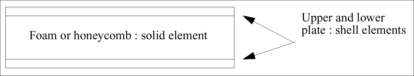

Solid + Shell Elements
For sandwich plates, if the foam or the honeycomb is very thick, it is possible to combine composite shells for the plates and solid elements for the sandwich.

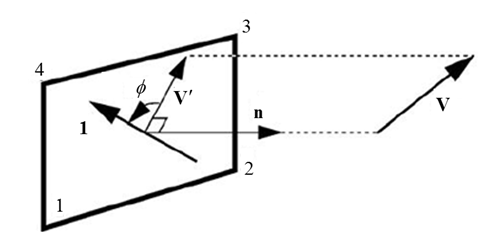

A global reference vector V MathType@MTEF@5@5@+= feaagKart1ev2aqatCvAUfeBSjuyZL2yd9gzLbvyNv2CaerbuLwBLn hiov2DGi1BTfMBaeXatLxBI9gBaerbd9wDYLwzYbItLDharqqtubsr 4rNCHbGeaGqiVu0Je9sqqrpepC0xbbL8F4rqqrFfpeea0xe9Lq=Jc9 vqaqpepm0xbba9pwe9Q8fs0=yqaqpepae9pg0FirpepeKkFr0xfr=x fr=xb9adbaqaaeGaciGaaiaabeqaamaabaabaaGcbaGaaCOvaaaa@36D6@ is used to define the fiber direction. The direction in which the material properties (or fiber direction) lay is known as the direction 1 of the local coordinate system of orthotropy. It is defined by the ϕ angle, which is the angle between the local direction 1 (fiber direction) and the projection of the global vector V MathType@MTEF@5@5@+= feaagKart1ev2aqatCvAUfeBSjuyZL2yd9gzLbvyNv2CaerbuLwBLn hiov2DGi1BTfMBaeXatLxBI9gBaerbd9wDYLwzYbItLDharqqtubsr 4rNCHbGeaGqiVu0Je9sqqrpepC0xbbL8F4rqqrFfpeea0xe9Lq=Jc9 vqaqpepm0xbba9pwe9Q8fs0=yqaqpepae9pg0FirpepeKkFr0xfr=x fr=xb9adbaqaaeGaciGaaiaabeqaamaabaabaaGcbaGaaCOvaaaa@36D6@ as shown in 図 3.
図 3. Fiber Direction Orientation
The shell normal defines the positive direction for ϕ . For elements with more than one layer, multiple ϕ angles can be defined.

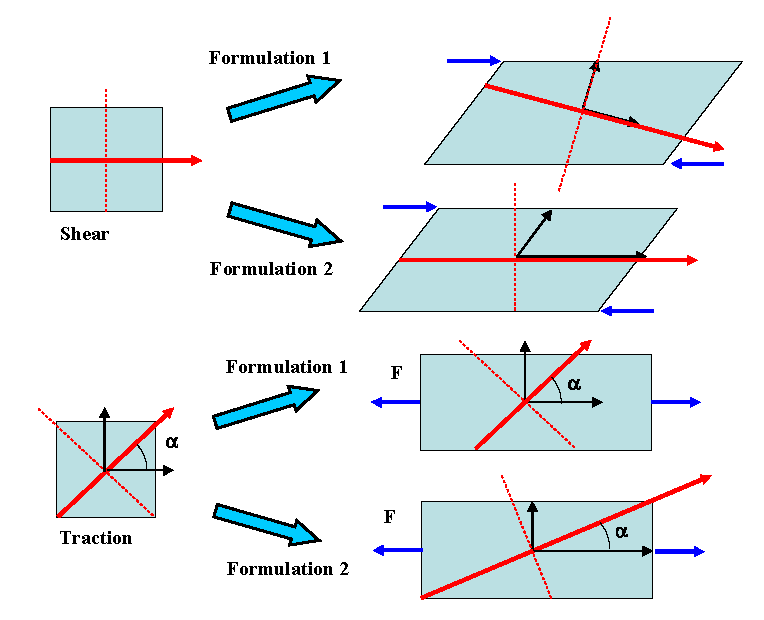

The fiber direction orientation may be updated by two different ways:
  1. Constant orientation in local corotational reference frame constant orientation in local isoparametric frame. The first formulation may lead to unstable models especially in the case of very thin shells (airbag modeling). In 図 4 the difference between the two formulations is illustrated for the case of element traction and shearing.
図 4. Fiber Direction Updating
