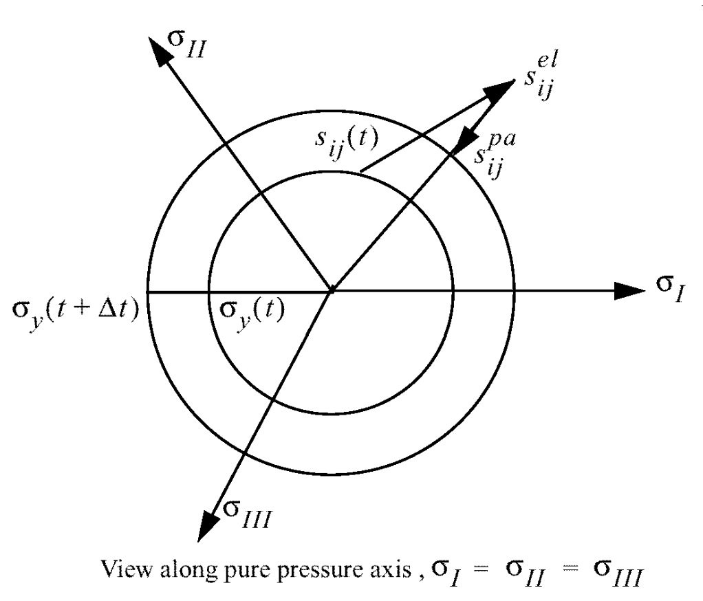

Radial Return
There are many possible methods for obtaining from the trial stress. The most popular method involves a
simple projection to the nearest point on the flow surface, which results in the radial
return method.
The radial return calculation is given in 式 9. 図 2 is a graphic representation of radial return.(9)
図 2. Radial Return
