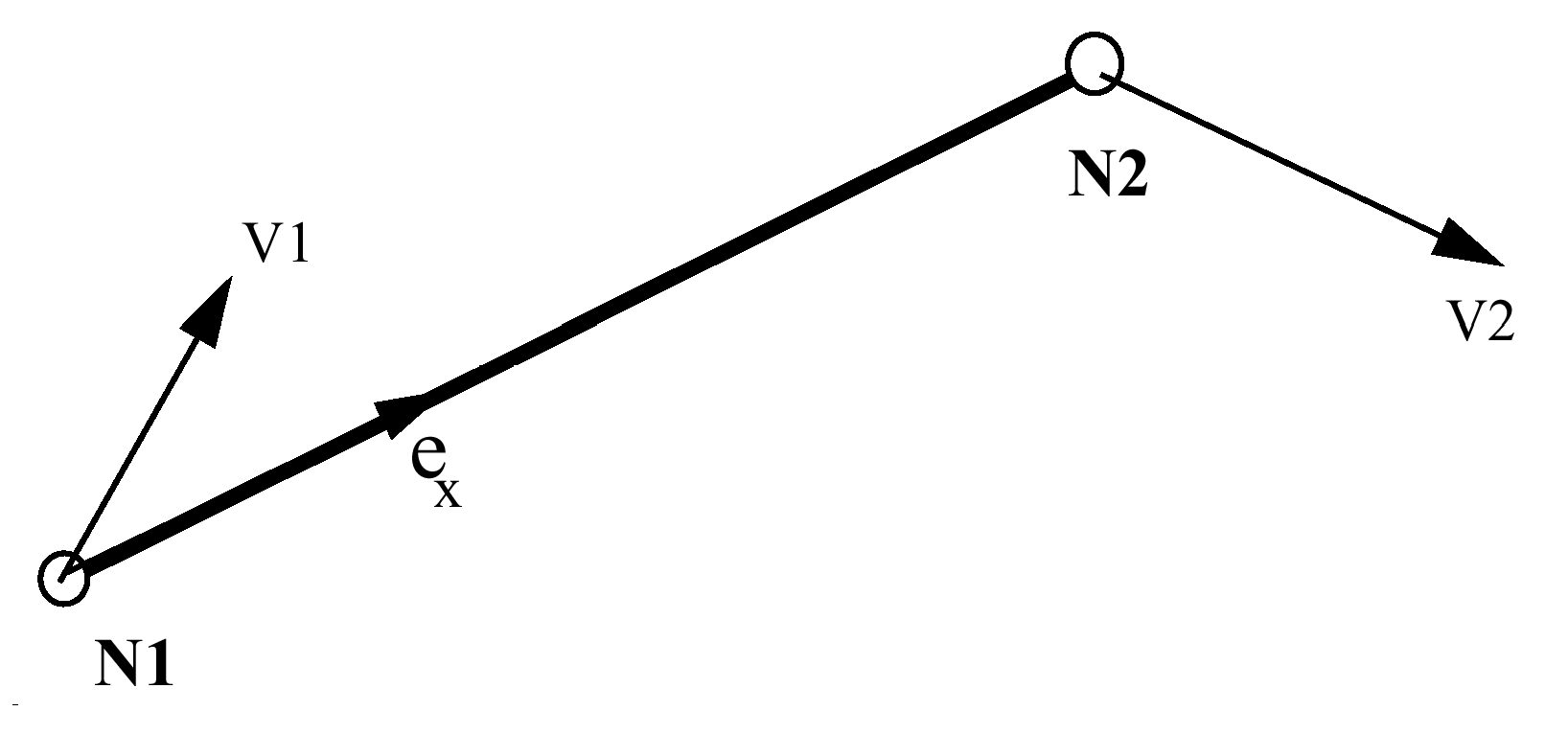

Rigid Body Motion
The rigid body motion of a truss element as shown in 図 2 shows the different velocities of
nodes 1 and 2. It is the relative velocity difference between the two nodes that produces a
strain in the element, namely ex. 図 2. Truss Motion
Strain
The strain rate, as shown in 図 2, is defined as:(3)

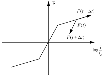

A generalized force-strain graph can be seen in 図 3. The force rate under elastic
deformation is given by:(5)
Where,
Elastic modulus
Cross-sectional area
In the plastic region, the force rate is given by:(6)
Where,
Gradient of the material curve at the deformation point
図 3. Force-Strain Relationship. (a) without gap; (b) with gap
In a general case, it is possible to introduce a gap distance in the truss definition. If gap is
not null, the truss is activated when the length of the element is equal to the initial
length minus the gap value. This results a force-strain curve shown in 図 3(b).
