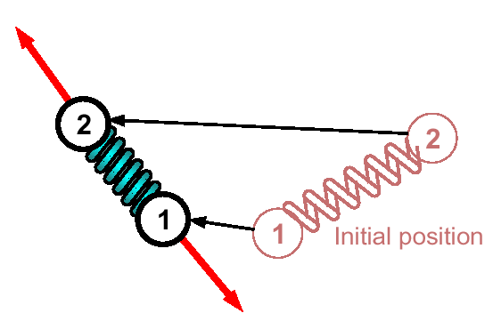

A spring may also have zero length. However, a one DOF spring must have 2 nodes.
The forces applied on the nodes of a one DOF spring are always colinear with direction through both nodes; refer to 図 4.
図 4. Colinear Forces

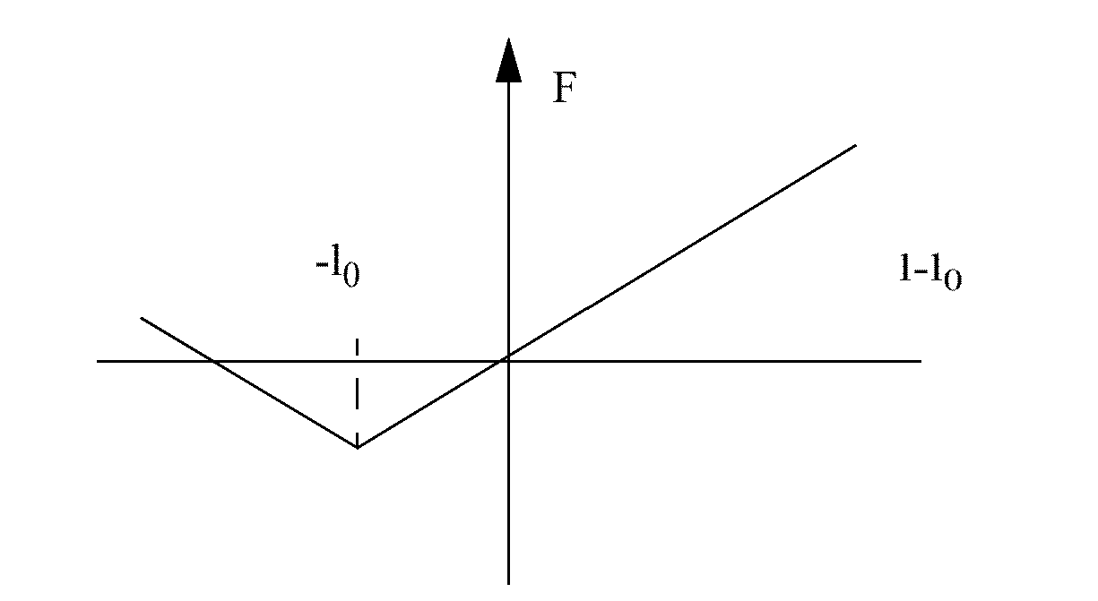

The general linear spring is defined by constant mass, stiffness and damping. These are all required in the property type definition. The relationship between force and spring displacement is given by:(4)
F = k ( l l 0 ) + c d l d t
図 5. Linear Force-Displacement Curve
The stability condition is given by 式 3:(5)
Δt= ( c 2 +km )c k

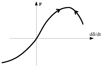

The hardening flag is set to 2 in this case and f f ( l l 0 ) is defined by a function. The hardening is decoupled for compression and tensile behavior:(10)
F = f ( l l 0 ) + C d l d t

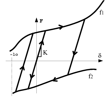

Nonlinear Elasto-plastic Spring: Kinematic Hardening
H=4
The hardening flag is set to 4 in this case and f 1 ( l l 0 ) and f 2 ( l l 0 ) (respectively maximum and minimum yield force) are defined by a function. The hardening is kinematic if maximum and minimum yield curves are identical:(11)

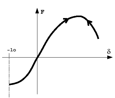

Nonlinear Elasto-plastic Spring: Nonlinear Unloading
H=5
The hardening flag is set to 5 in this case and f ( δ ) and f 2 ( δ max ) MathType@MTEF@5@5@+= feaagKart1ev2aaatCvAUfeBSjuyZL2yd9gzLbvyNv2CaerbwvMCKf MBHbqefqvATv2CG4uz3bIuV1wyUbqedmvETj2BSbqefm0B1jxALjhi ov2DaebbnrfifHhDYfgasaacH8srps0lbbf9q8WrFfeuY=Hhbbf9v8 qqaqFr0xc9pk0xbba9q8WqFfea0=yr0RYxir=Jbba9q8aq0=yq=He9 q8qqQ8frFve9Fve9Ff0dmeaacaGacmGadaWaaiqacaabaiaafaaake aacaWHMbGaaGOmamaabmaabaGaeqiTdq2aaSbaaSqaaiGac2gacaGG HbGaaiiEaaqabaaakiaawIcacaGLPaaaaaa@40BA@ (maximum yield force and residual deformation, respectively) are defined by a function. Uncoupled hardening in compression and tensile behavior with nonlinear unloading:(12)
With δ = l l 0 .
図 10. Nonlinear Unloading Force-Displacement Curve

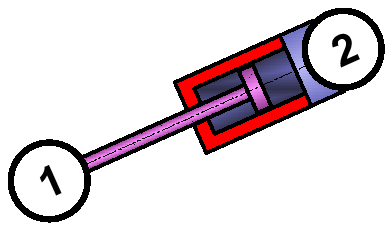

Nonlinear Dashpot
The input properties for a nonlinear dashpot are very close to that of a spring. The required values are:
  • Mass, M MathType@MTEF@5@5@+= feaagKart1ev2aaatCvAUfeBSjuyZL2yd9gzLbvyNv2CaerbuLwBLn hiov2DGi1BTfMBaeXatLxBI9gBaerbd9wDYLwzYbItLDharqqtubsr 4rNCHbGeaGqiVu0Je9sqqrpepC0xbbL8F4rqqrFfpeea0xe9Lq=Jc9 vqaqpepm0xbba9pwe9Q8fs0=yqaqpepae9pg0FirpepeKkFr0xfr=x fr=xb9adbaqaaeGaciGaaiaabeqaamaabaabaaGcbaGaamytaaaa@36C8@ .
  • A function defining the change in force with respect to the spring displacement. This must be equal to unity:
    f ( l l 0 ) = 1
  • A function defining the change in force with spring displacement rate,
    g ( d l / d t )
  • The hardening flag in the input must be set to zero.
The relationship between force and spring displacement and displacement rate is:(13)
F = f ( l l 0 ) g ( d l d t ) = g ( d l d t )
A nonlinear dashpot property is shown in 図 11.
図 11. Nonlinear Dashpot Force Curve
