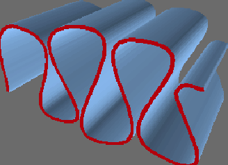

During a contact between two solid bodies, the surface in contact is usually continuous and only slightly curved. On the other hand, during the buckling of a structure, the contacts, resulting from sheet folding, are many and complex. Globally, the contact is no longer between two identified surfaces, but in a surface impacting on itself. The algorithms able to describe this type of contact are “auto-impacting” algorithms. Especially adapted to shell structures, they still can be used to simulate the impact of the external surface of a solid (3D element) on itself.
The main capabilities of the auto-contact can be summarized by the following functionalities:
図 1.
  • Capacity to make each point of the surface impact on itself
  • Capacity to impact on both sides of a segment (internal and external)
  • Possibility for a point of the surface to be wedged between an upper and a lower part
  • Processing of very strong concavities (will complete folding)
  • Reversibility of the contact, thereby authorizing unfolding after folding or the simulation of airbag deployment.

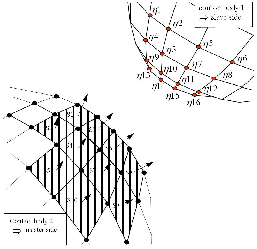

図 2. Contact Nodes to Surface
The contact is detected based on the criteria of distance between a group of nodes and a meshed surface. The distance between a node and the surface of a triangular or quadrangular segment is evaluated, locally.
Symmetrized contact nodes to surface
The symmetrization of the previous formulation makes it possible to model a contact between two surfaces, as the group of nodes of the first surface can impact the second group and vice-versa.

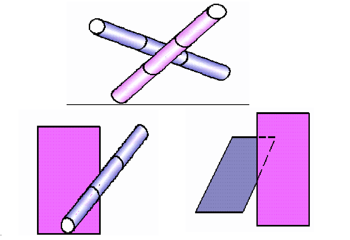

図 3. Contact Edges to Edges
This formulation makes it possible to model contacts between wire framed structures or between edges of two-dimensional structures. Contact is detected based on the criteria of distance between two segments. This formulation can also be used to describe in an approximate way the surface to surface contact.

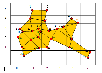

Sorting by boxes consists in dividing space in to steady boxes (not necessarily identical) in which the nodes are placed. The search for closest nodes is limited to one box and the twenty-six neighboring boxes. The cost of this sorting is linear (N) for regular meshes. For irregular meshes, an adaptation is possible but its interest becomes less interesting compared with the next solution. This three-dimensional sorting is of the same kind as one-way sorting with direct addressing or needle sort.
図 6.
In order to limit the memory space needed, first count the number of nodes in each box, thereby making it possible to limit the filling of those boxes that are not empty. In the two-dimensional example shown above, nodes are arranged in the boxes as described in the following table. With this arrangement, the calculation of distances between nodes of the same box is not a problem. On the other hand, taking into account the nodes of neighboring boxes is not straightforward, especially in the horizontal direction (if the arrangement is first made vertically, as in this case). One solution is to consider three columns of boxes at a time. Another solution, more powerful but using more memory, would be for each box to contain the nodes already located there plus those belonging to neighboring boxes. This is shown in the third series of columns in the following table. Once this sorting has been performed, the last step is to calculate the distances between the different nodes of a box, followed by the distance between these nodes and those of the neighboring box. In box 0,3 for example, fifteen distances must be calculated.
11-14, 11-3, 11-8, 11-12, 11-15, 11-16, 11-17, 11-18, 14-3, 14-8,
14-12, 14-15, 14-16, 14-17, 14-18.
Box Nodes Nodes of the Neighboring Box
0,0 26     21
0,1 21     15 16 17 22 26
0,2 16     8 11 12 14 15 17 21 22 26
0,3 11 14   3 8 12 15 16 17 18
1,1 22     15 16 17 19 21 23 26
1,2 15 17   8 11 12 13 14 18 16 19 21 22 23
1,3 8 12 18 3 5 11 13 14 15 16 17 19
1,4 3     1 2 5 11 12 13 14 18
1,5 1     2 3 5
2,1 23     15 17 19 22
2,2 19     8 9 10 12 13 15 17 18 22 23
2,3 13     3 5 8 9 10 12 15 17 18 19
2,4 5     1 2 3 8 9 10 12 13 18
2,5 2     1 3 5
3,3 9 10   4 5 6 13 19 20
4,1 24     20 25 27
4,2 20     9 10 24
4,4 4 6   9 10
5,0 25 27   24

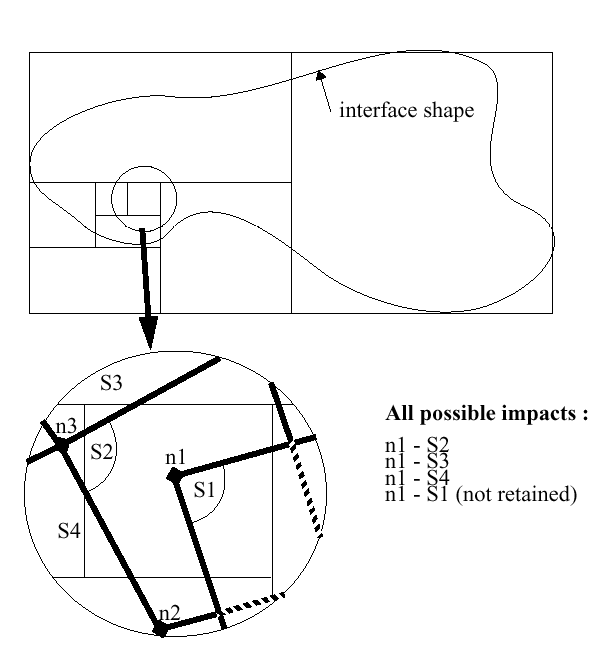

The octree is a three-dimensional adaptation of fast sorting. Space is divided into eight boxes, each one being subdivided into eight boxes. In this way a tree with eight branches per node is obtained. An alternative to the "octree", closer to the quick sort, consists in successively dividing space in two equal parts, according to directions X, Y, or Z. This operation is renewed for each of the two resulting parts as long as some segments or nodes are found in the space concerned. The main advantage to this algorithm, as compared to sorting by boxes, lies in the fact that its performance is affected neither by the irregularity of the mesh, nor by the irregularity of the model. The cost of this algorithm is logarithmic (N*Log(N)).
図 7. Possible Impact of Node n1
In order to illustrate the 3D quick sort, consider a search for node-segment proximity. At each step, space is successively divided into two equal parts, according to directions X, Y or Z. The group of nodes is thus separated into two subsets. You thereby obtain a tree organization with two branches per node. After each division, a check is made to determine whether the first of the two boxes must be divided. If so, it will be divided similar to the previous one. If not, the next branch is then checked. This recursive algorithm is identical to the regular fast sorting one.
The segments are also sorted using the spatial pivot. The result of the test can lead to three possibilities: the segment is on the left side of the pivot, on the right side of the pivot or astride the pivot. In the first two cases, the segments are treated similar to the nodes, but in the third situation, the segment is duplicated and placed on both sides.
Among the different criteria that can be used to stop the division are the following situations:
  • The box does not contain any nodes
  • The box does not contain any segments
  • The box contains sufficiently few elements that the calculation of distance of all the couples is more economical
  • The dimension of the box is smaller than a threshold

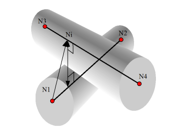

Edge to Edge Contact
The formulation of edge-to-edge contact is similar to that of node-to-segment contact. The gap surrounding each edge defines a cylindrical volume. The contact is detected if the distance between the two edges is smaller than the sum of the gaps of the two edges. The distance is then calculated as:
2   N 1 N i → = ( 1 − s ) N 1 N 3 → + ( 1 + s ) N 1 N 4 → D = | N 1 N i → − ( N 1 N → i   N 1 N 2 → / N 1 N 2 ¯ 2 ) N 1 N 2 → | ∂ D / ∂ s = 0
The force of penalty is calculated as in node-to-segment contact. It is applied to the nodes N 1 MathType@MTEF@5@5@+= feaagKart1ev2aaatCvAUfeBSjuyZL2yd9gzLbvyNv2CaerbuLwBLn hiov2DGi1BTfMBaeXatLxBI9gBaerbd9wDYLwzYbItLDharqqtubsr 4rNCHbGeaGqiVu0Je9sqqrpepC0xbbL8F4rqqrFfpeea0xe9Lq=Jc9 vqaqpepm0xbba9pwe9Q8fs0=yqaqpepae9pg0FirpepeKkFr0xfr=x fr=xb9adbaqaaeGaciGaaiaabeqaamaabaabaaGcbaGaamOtaiaaig daaaa@3784@ , N 2 MathType@MTEF@5@5@+= feaagKart1ev2aaatCvAUfeBSjuyZL2yd9gzLbvyNv2CaerbuLwBLn hiov2DGi1BTfMBaeXatLxBI9gBaerbd9wDYLwzYbItLDharqqtubsr 4rNCHbGeaGqiVu0Je9sqqrpepC0xbbL8F4rqqrFfpeea0xe9Lq=Jc9 vqaqpepm0xbba9pwe9Q8fs0=yqaqpepae9pg0FirpepeKkFr0xfr=x fr=xb9adbaqaaeGaciGaaiaabeqaamaabaabaaGcbaGaamOtaiaaig daaaa@3784@ , N 3 MathType@MTEF@5@5@+= feaagKart1ev2aaatCvAUfeBSjuyZL2yd9gzLbvyNv2CaerbuLwBLn hiov2DGi1BTfMBaeXatLxBI9gBaerbd9wDYLwzYbItLDharqqtubsr 4rNCHbGeaGqiVu0Je9sqqrpepC0xbbL8F4rqqrFfpeea0xe9Lq=Jc9 vqaqpepm0xbba9pwe9Q8fs0=yqaqpepae9pg0FirpepeKkFr0xfr=x fr=xb9adbaqaaeGaciGaaiaabeqaamaabaabaaGcbaGaamOtaiaaig daaaa@3784@ , N 4 MathType@MTEF@5@5@+= feaagKart1ev2aaatCvAUfeBSjuyZL2yd9gzLbvyNv2CaerbuLwBLn hiov2DGi1BTfMBaeXatLxBI9gBaerbd9wDYLwzYbItLDharqqtubsr 4rNCHbGeaGqiVu0Je9sqqrpepC0xbbL8F4rqqrFfpeea0xe9Lq=Jc9 vqaqpepm0xbba9pwe9Q8fs0=yqaqpepae9pg0FirpepeKkFr0xfr=x fr=xb9adbaqaaeGaciGaaiaabeqaamaabaabaaGcbaGaamOtaiaaig daaaa@3784@ and therefore ensures the equilibrium of forces and moments.
