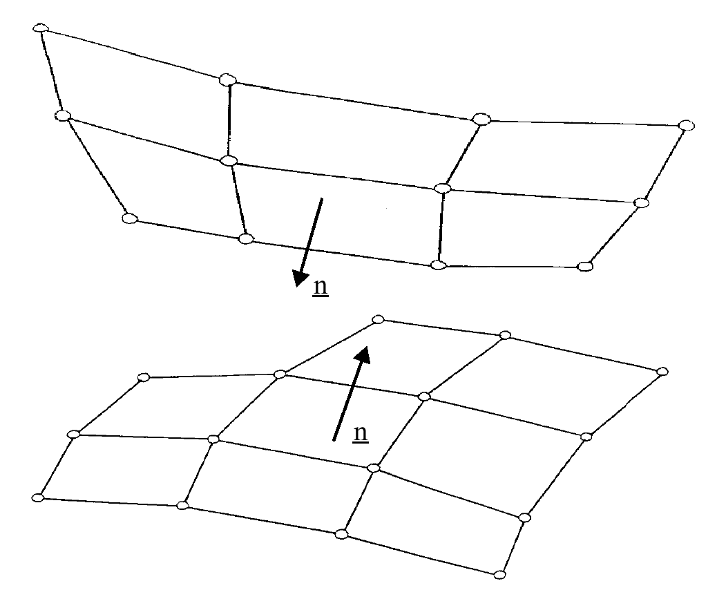

図 1. Surfaces 1 and 2 with Facing Normals

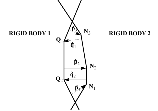

Contact Force
図 2. Especially Suited for Rigid Bodies
(3)
F N i = p i + q N i p j q k f ( M A X ( p k , q j ) )
q N i is the contribution to node N i of vector q i distributed on the segment penetrated by node Q i .
