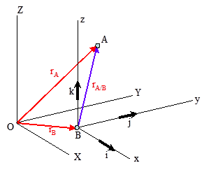

Reference Axes Transformation
Consider now the curvilinear motion of two particles A and B in space. Study at first the
translation of a reference without rotation. The motion of A is observed from a translating
frame of reference x-y-z moving with the origin B (図 2). The position vector of A relative to B
is:(11)
Where , and are the unit vectors in the moving x-y-z system. As there is no
change of unit vectors in time, the velocity and the acceleration are derived
as:(12)
(13)
The absolute position, velocity and acceleration of are then:(14)
図 2. Vector Location with a Moving Reference
