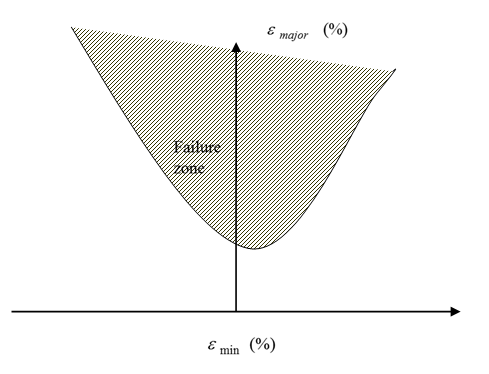

Forming Limit Diagram for Failure (FLD)
図 1. Generic Forming Limit Diagram (FLD)

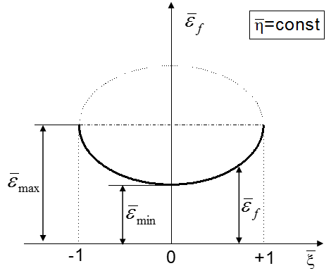

Bao-Xue Wierzbicki Failure Model
- for solids:
If Imoy=0:
If Imoy=1:
- for shells:
- Hydrostatic stress
- The von Mises stress
- Third invariant of principal deviatoric stresses
図 2. Graphical Representation of Bao-Xue-Wierzbicki Failure Criteria

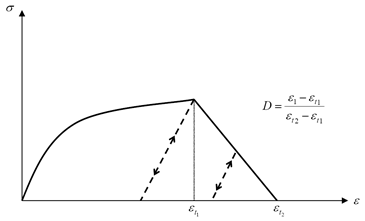

Strain Failure Model
図 3. Strain Failure Model

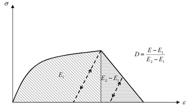

Energy Density Failure Model
図 4. Strain Failure Model
