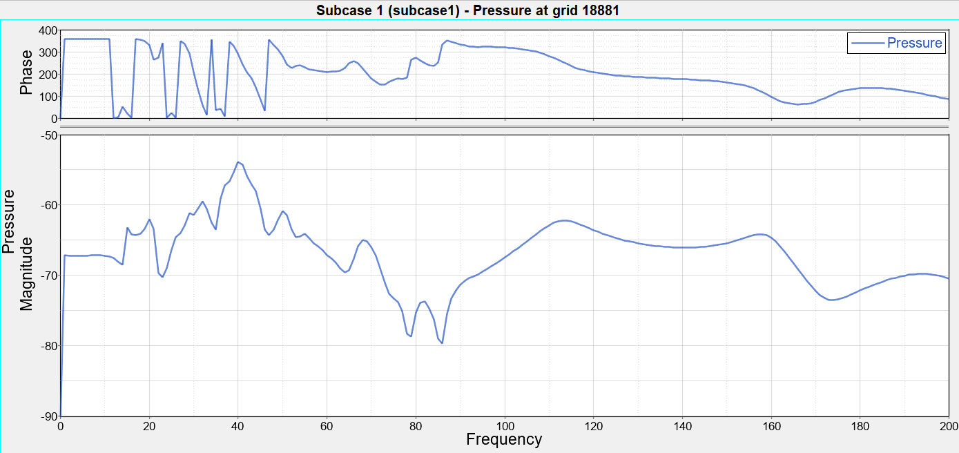

The purpose of this tutorial is to evaluate the vibration characteristics of a half car model subjected to Fluid - Structure interaction. The fluid that is being referred to is air. Essentially, the noise level or the sound level is evaluated inside the car at a location near the ear of the driver which is the main response location inside the fluid.

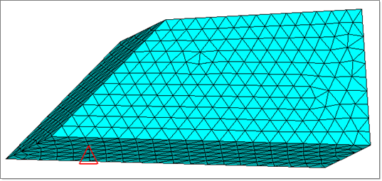

Figure 1. Half Car Model
The half car model is excited at the bottom of the car, as shown by a red constraint symbol (triangle) in Figure 1. The excitation provided is with the application of a unit load along the direction of the height of the car (Z-axis).

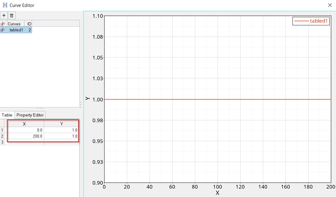

Create a Frequency Range Table
Create a Frequency Dependent Dynamic Load

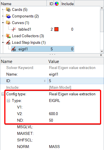

Create the Modal Method for Eigenvalue Analysis

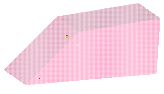

Create a Set of Nodes
- In the Model Browser, right-click and select .
- For Name, enter SETA.
- For Card Image, select SET_GRID.
- Leave the Set Type switch set to non-ordered type.
- For Entity IDs, select Nodes from the selection switch.
- Click Nodes and select nodes 18881.
- Click proceed.

next to the Data field and enter, F1= 0.0, DF=
1.0, and NDF= 200.
