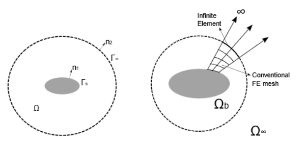

Figure 1. Acoustic Problem on an Infinite Domain
Implementation
Considering the domain in the figure above, the region surrounding the structure (shaded area) is modeled using a conventional fluid FE mesh, and the far field is modeled using infinite elements defined on a 2D interface between the finite and infinite (unbounded) domains.

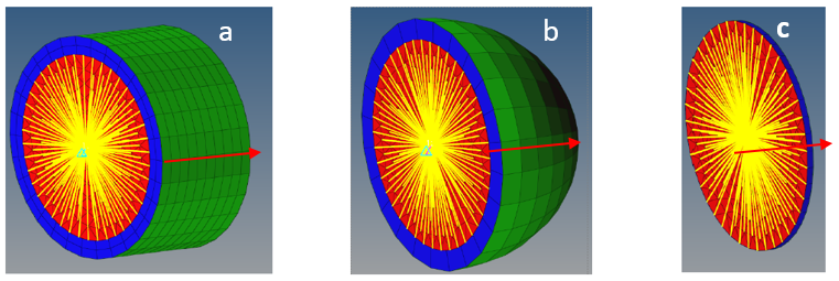

- Infinite Elements modeling practice can be typically recommended as:
Figure 2. Modeling Practices for Infinite Elements . (Green elements: Infinite Elements, Red arrow indicates direction of the receiver (semi-infinite domain), Blue Elements: Acoustic elements)Correct Modeling Practices- In Figure 2(a), infinite elements are on the skin of the fluid acoustic elements covering both sides (front and lateral) in the direction of the receiver.
- In Figure 2(b), infinite elements are on the skin of the fluid acoustic elements covered through curved surface in the direction of the receiver.
Incorrect Modeling Practices:- In Figure 2(c), infinite elements are the skin on the fluid acoustic elements covering one of the sides (front side) in the direction of the receiver.
- Normals of infinite elements should always point away from the pole.

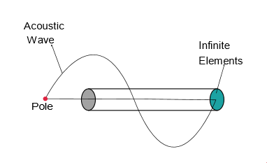

- For some geometries of the finite domain (that includes the structure and acoustic
cavity region, for example, the domain enclosed by the layer of infinite elements), the
distance between the pole to the interface should allow for the propagation of one
acoustic wavelength (Figure 3). This simply means.
(6)
Figure 3. Distance from the Pole to the IE Layer must accommodate one Acoustic Wavelength
