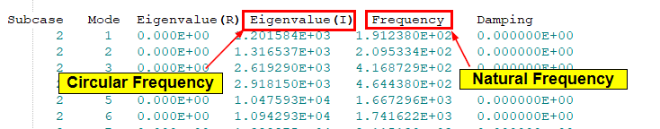

In the .out file, for the complex modes, the complex eigenvalue is the same as the circular frequency, while the frequency printed is the natural frequency.
Figure 1. Complex eigenvalue table in the .out file
