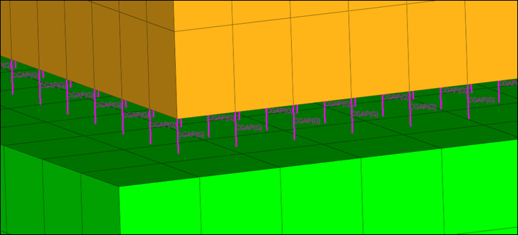

Node-to-Surface Discretization
The Node-to-Surface Discretization approach involves the creation of contact elements linking the Main Surfaces to Secondary Nodes.
- One secondary node
- A few main nodes
- One main face including the main nodes
- One projection from the secondary node to the main face
Figure 3.
Figure 4.
- For small displacement analysis, N2S contact elements are created with CGAPG as the core.
- For Large displacement analysis, N2S contact elements consist of non-CGAPG cores.
- Each N2S contact element consists of a secondary node, a few main nodes, and one main face.
- Within a contact interface, secondary nodes should be unique to each N2S contact element. For instance, two different N2S contact elements cannot consist of the same secondary node.
- Within a contact interface, main faces can be shared among N2S contact elements.

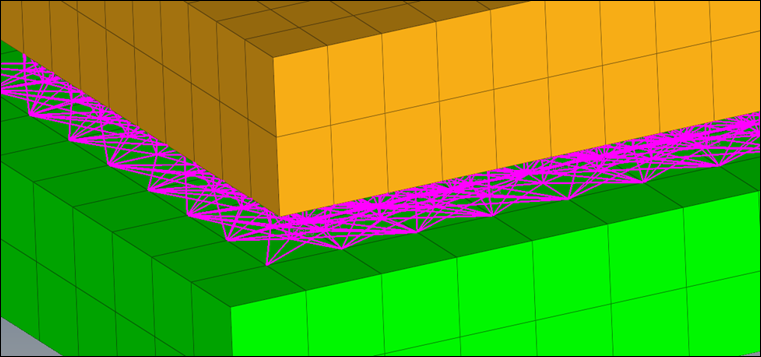

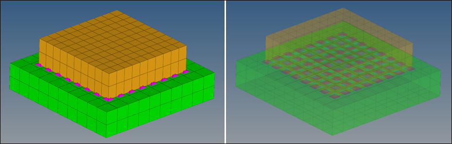

Surface-to-Surface Discretization
The Surface-to-Surface Discretization approach involves the creation of contact elements linking the Main Surfaces to Secondary Surfaces.
Figure 6.
- One core secondary node
- Several secondary nodes surrounding the “core” secondary node
- One or more secondary faces including the secondary nodes and sharing the “core” secondary node
- Several main nodes
- One or more main faces including the main nodes
- One or more projections from the secondary faces to the main faces
Figure 7.
- Multiple S2S contact elements have different “core” secondary nodes (that is, each S2S contact element has a unique “core” secondary node).
- Secondary face(s) may be shared among multiple S2S contact elements.
- Multiple S2S contact elements may share one or more main face(s).

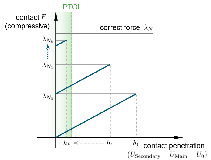

Augmented Lagrange Multiplier (ALM) Method (Nonlinear Analysis)
The ALM method does not introduce real Lagrange multipliers as additional unknown variables in the system and can instead be categorized as a variant of the penalty-based method. When the ALM method is activated, the contact pressure data in the last converged results are employed as constant multipliers in the pressure formulation of the succeeding iterations, as shown in the force-penetration curve in Figure 12, where λ ̅_(N k-1) is the normal force obtained from the last converged state. The ALM method uses the contact pressure to determine the open/close status of a contact element.
The ALM method is applicable to Nonlinear Static and Transient Analysis and can be activated by CONTPRM,ALM,YES or the ALM continuation line on the PCONT Bulk Data Entry. Additional augmentations iterations are carried out when a time increment is converged while the penetration tolerance, defined with CONTPRM,ALMPTOL or the PTOL field on the PCONT Bulk Data Entry, is not satisfied.

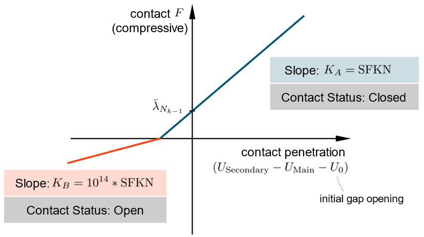

The schematic augmentation process of the contact force is visualized in Figure 13 where the contact force approaches the correct value after a few augmentations, with the subscript k (k=0, 1, …) denoting the augmentation index. Usually, the default tolerance is recommended such that a balance between accuracy and computational cost is achieved. Pressure augmentation also happens naturally at new time increments without direct augmentation iterations and setting the tolerance too strict may result in excessive number of augmentation iterations.
The ALM method can achieve an accurate result on the contact interface with relatively soft penalty stiffness, though it may result in an increased number of iterations in some cases. The penalty stiffness for the ALM method is controlled by CONTPRM,ALMSFKN or the SFKN field on the PCONT Bulk Data Entry, and is independent of any STIFF options mentioned in the preceding sections. Option SFKN=AUTO determines the value of the normal penalty stiffness for each contact element using the stiffness of surrounding elements along the normal direction of the surface. Generally, the AUTO stiffness for the ALM method is softer than the AUTO stiffness employed in the penalty-based contact. Additional options AUTO, HARD, SOFT or Real<0.0 for SFKN are available as a scaling factor applied on the stiffness value via SFKN=AUTO.
Figure 12. Force-Penetration curve of the ALM method for a contact element at augmentation #k
Figure 13. Schematic augmentation process of contact force

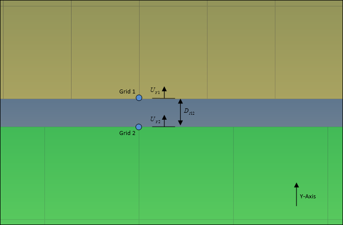

MPC Equation Setup
Figure 20.
MPC Equation
- Relative displacement between grid points 1 and 2 along the Y-Axis
- Initial contact gap between the grid points 1 and 2 along the Y-Axis
- Displacement of grid point 1 in the positive Y-Axis
- Displacement of grid point 2 in the positive Y-Axis
Since and are not inherently available in the model, SPOINT's are created to represent these quantities. is related to an SPC Bulk Data Entry via the SPOINT ID and the value of the initial contact gap is set on the D field on the SPC entry. is related to a SUPORT Bulk Data Entry via the SPOINT ID. PARAM,CDPCH can be used to control the printing of the final state of DMIG,CDSHUT after Fast Contact Analysis. PARAM,CDPRT can be used to control the printing of violations in intermediate iterations in Fast Contact Analysis.
