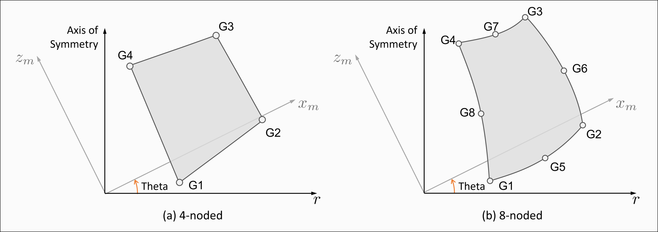

  4. The grid ordering of G1 through G8 is defined as shown in Figure 1. All grids and the axis-of-symmetry must be on the same plane, and the grids cannot span across the axis-of-symmetry on this plane.
    Figure 1. CQAXIG Definition
  5. If the PAXIG entry referenced in field 3 references a MAT3 entry, material properties and stresses are always given in the xm-zm coordinate system.
