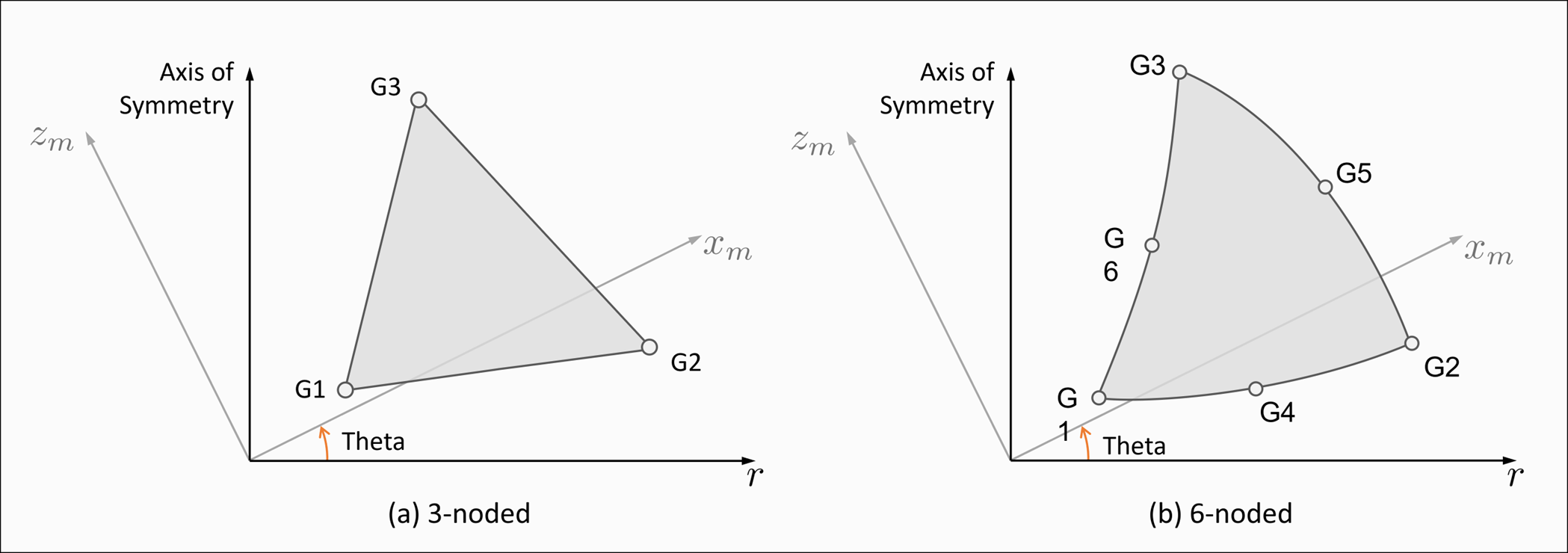

  4. The grid ordering of G1 through G6 is defined as shown in Figure 1. All grids and the axis-of-symmetry must be on the same plane, and the grids cannot span across the axis-of-symmetry on this plane.
    Figure 1. CTAXIG Definition
