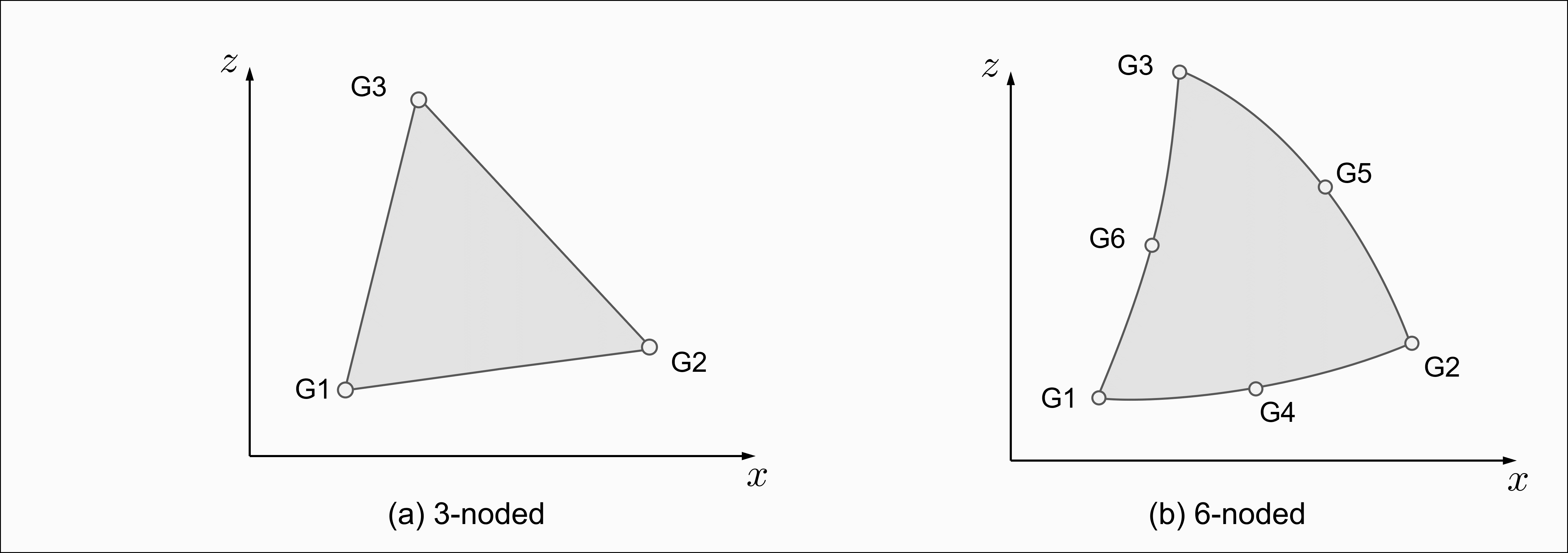

- The Grid ordering of
G1 through G6 is defined as:
Figure 1. - The continuation is optional.
- The definition of the elemental coordinate system and material orientation angle theta is the same as defined for CTRIA3 and CTRIA6, depending on the number of nodes of CTPSTS elements.
- Plane stress analysis defined in x-y plane is supported, that is. the axis labels of “z” can be replaced by “y”. The out-of-plane normal direction defined by the corner node sequence with the right hand rule should point to the z direction if the element is in the x-y plane, or the -y direction if in the x-z plane.
