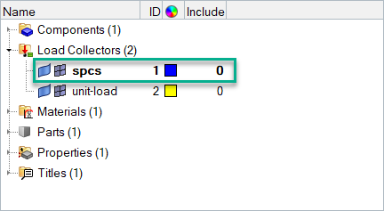

Apply Loads and Boundary Conditions

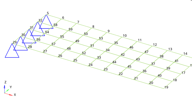

Create Constraints

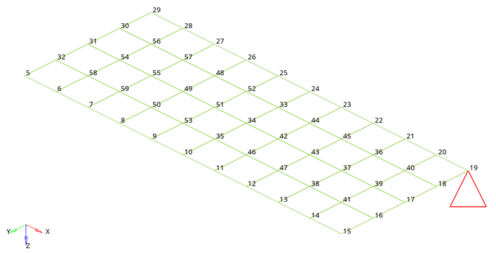

Create a Unit Load at a Point on the Flat Plate

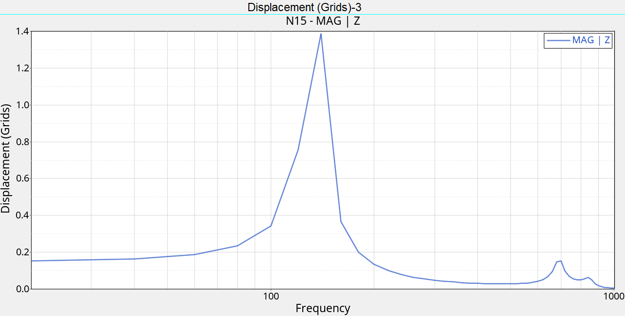

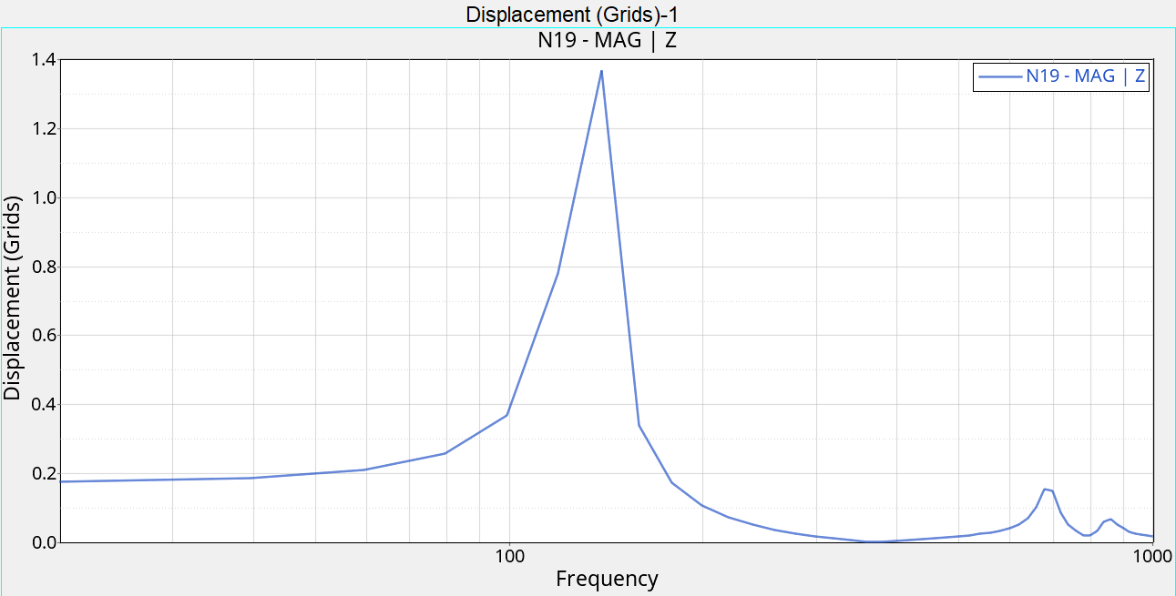

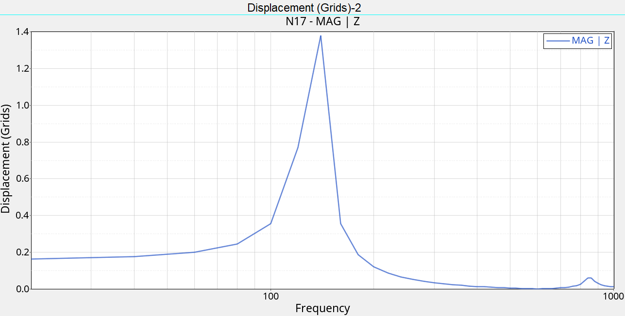

View the Results
This step describes how to view displacement results (.mvw file) in HyperGraph and also explains the displacement output (.disp file) from this run.
