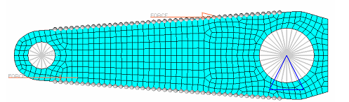

Design regions are identified by the grids on the grids are the structure (the edge of a shell structure or the surface of a solid structure). These grids are listed on the DSHAPE entry.
The outer boundary of a structure is altered to meet with pre-defined objectives and constraints. Allows these design grids to move in one of two ways:- For shell structures, grids move normal to the surface edge in the tangential plane.
- For solid structures, grids move normal to the surface.
During free-shape optimization, the normal directions change with the change in shape of the structure; thus, for each iteration, the design grids move along the updated normals.

For the Vertex Morphing free-shape optimization, the optimization design space can be defined as:- For shells – Grids in the entire design space can be selected. It does not have to only be the edge grids of the shell design domain.
- For solids – Grids should be selected on the surface of the solid
design space. Even if the internal grids are selected, then they are
ignored for the creation of design variables. Note: In the rare case wherein only internal solid grids are selected, the run will error out.

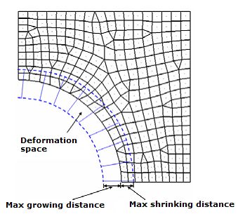

Maximum Shrinkage and Growth
| PERT | DTYPE | MVFACTOR | NSMOOTH | MXSHRK | MXGROW | SMETHOD | NTRANS |
Figure 9. Deformation Space Defined by the Maximum Growing/Shrinking Distance
For more details and an example, refer to Mesh Barrier Constraint.

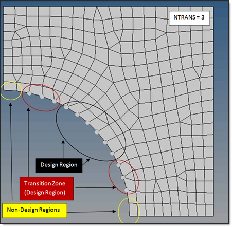

Additional Treatment to Grids in the Transition Zone
When the entire surface or edge of a system is not a design zone and both design and non-design regions exist adjacent to one another, a transition zone can be defined using NTRANS which helps to smooth out the transition. Sharp changes can occur in the design region during optimization and the sections of the design region closest to the non-design region are designated as a transition zone where the corresponding location of the adjacent non-design region is taken into consideration allowing for a smoother transition from the design to non-design region.
Figure 10. Defining the Transition Zone Grid Points for a Smooth Transition between Design and Non-Design Regions (NTRANS=3)
- The non-design nodes (marked by yellow circles), which do not move during Freeshape optimization.
- Design nodes in transition zone (highlighted nodes enclosed by red circles, defined by NTRANS=3)
- Design nodes that are NOT in the transition zone (highlighted nodes enclosed by a black circle)
Figure 11. Defining the Transition Zone Grid Points for a Smooth Transition between Design and Non-Design Regions (NTRANS=3)

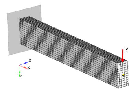

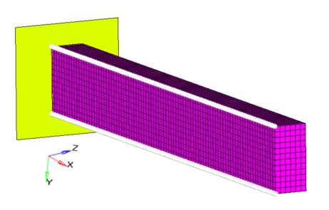

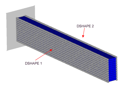

Example: CTYPE=VECTOR
This example demonstrates a simple case where it is necessary to use the "DIR" constraint type to force grids to move in a predefined direction.
Figure 12.
Figure 13.
Figure 14.
Figure 15.

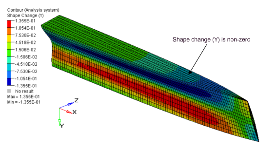

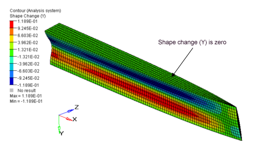

1-plane Symmetry Constraint
An advantage of this constraint is that it will produce symmetric designs regardless of the initial mesh, loads or boundary conditions.
It is often desirable to produce a symmetric design. Even if the loads and boundary conditions are perfectly symmetric, there is no guarantee that the resulting design will be perfectly symmetric. In order to ensure a symmetric design, a symmetry constraint must be defined.

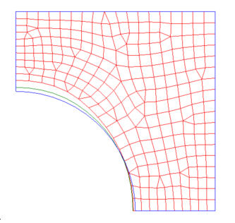

Example: 1-plane Symmetry Constraints in 2-dimensions
Figure 21. 2D Model Showing Free-shape Design Grids
Figure 22. Result Without Symmetry Constraint
Figure 23. Result With Symmetry Constraint (XZ Plane)

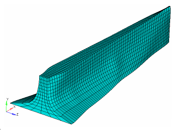

Example: 1-plane Symmetry Constraints in 3-dimensions
Figure 24. 3D Model Showing Free-shape Design Grids
Figure 25. Result Without Symmetry Constraint
Figure 26. Result With Symmetry Constraint (XZ Plane)

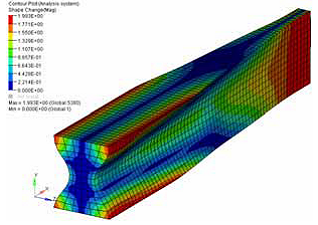

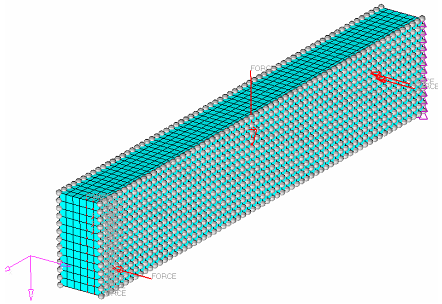

Extrusion Constraint
Using extrusion manufacturing constraints with free-shape optimization, constant cross-section designs can be attained for solid models (regardless of the initial mesh, loads or boundary conditions).
It is often desirable to produce a design with a constant cross-section along a given path, particularly in the case of parts manufactured by an extrusion process.
| EXTR | ECID | XE | YE | ZE |

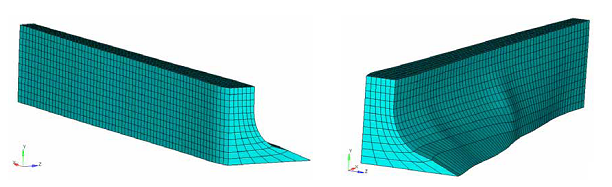

Two types of extrusion path are available for free-shape optimization - straight line and circular.
Example: Extrusion Constraint Along a Straight Line
Figure 27. Result With Extrusion Path (Along x-axis)

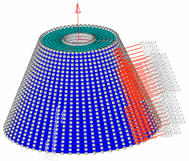

Example: Extrusion Constraint Along a Circular Path
Figure 28. Model Showing Free-shape Design Grids
Figure 29. Result Without Extrusion Path
Figure 30. Result With Extrusion Path (Circular)

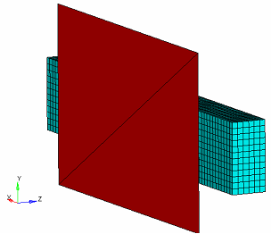

Mesh Barrier Constraints
The mesh barrier is composed of special shell elements (BMFACE), and in order to keep computational effort to a minimum, as few elements as possible should be used in its definition.
Aside from shrinkage and growth parameters and side constraints, a more general capability to limit the extent of the total deformation of the design region is available by way of defining a mesh barrier constraint.
| BMESH | BMID |
Example: Mesh Barrier Constraint
Figure 36. Model With Mesh Barrier
Figure 37. Result Without Mesh Barrier Constraint
Figure 38. Result With Mesh Barrier Constraint
Figure 39. Result Combining Mesh Barrier Constraint and 1-plane Symmetry Constraint
From the results, you can see how the mesh barrier constrains the model deformation, but if the mesh barrier is not big enough, the design region deformation is unconstrained beyond its limits.
