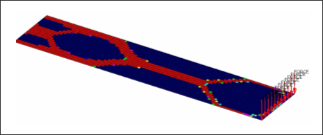

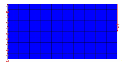

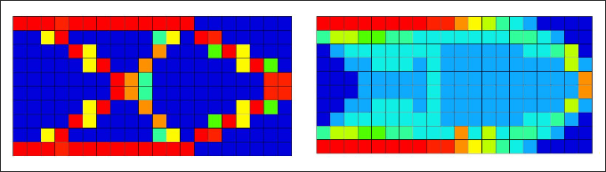

Example: Cantilever Plate
The cantilever plate is shown in the following figure. Base-plate thickness T0 is zero. The optimization problem is stated as:
Minimize Compliance
Figure 2. Cantilever Plate
Figure 3. Topology Result (left); Free-size Result (right)
Figure 4.
It is not surprising to see that the free-size design outperforms the topology design in terms of compliance since continuous variation of thickness offers more design freedom.

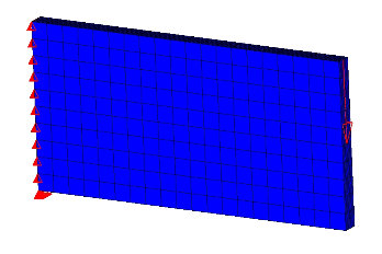

Figure 5. Cantilever Plate - 3D Model

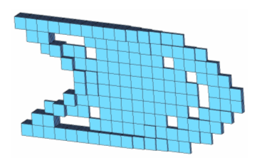

Figure 6. 3D Topology Result
The topology design of the 3D model shown above looks similar to the free-size results shown previously. This should not be surprising because when the plate is modeled in 3D, a variable thickness distribution becomes possible under the topology formulation that seeks a discrete density value of either 0 or 1 for each element. If infinitely fine 3D elements are used, a continuous variable thickness of the plate can be achieved via topology optimization. The motivation for the introduction of free-size is based on the conviction that limitations due to 2D modeling should not become a barrier for optimization formulation. In regards to the 3D modeling of shell, topology optimization is equivalent to the application of extrusion constraint(s) in the thickness direction of a 3D modeled shell.

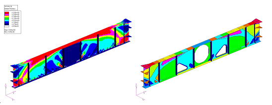

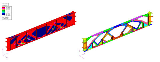

In most cases, variable thickness of a shell structure is achieved through step-wise change of thickness. Free-size results provide a different concept about how the zones of different thicknesses should be designed.
Detailed size optimization can then be performed to fine tune the final design. This process is illustrated in Example: Supporting Beam of an Airplane Door Structure.
Figure 8. Supporting Beam of an Airplane Door Structure
Figure 9. Free-size Result (left); Interpreted Zones of Constant Thicknesses (right)
Figure 10. Topology Result (left); Interpreted Zones of Constant Thicknesses (right)
