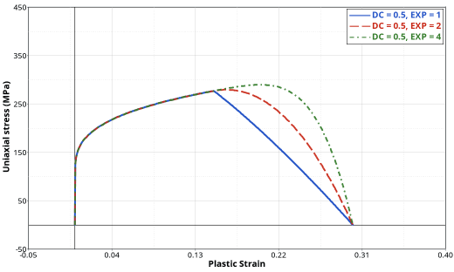

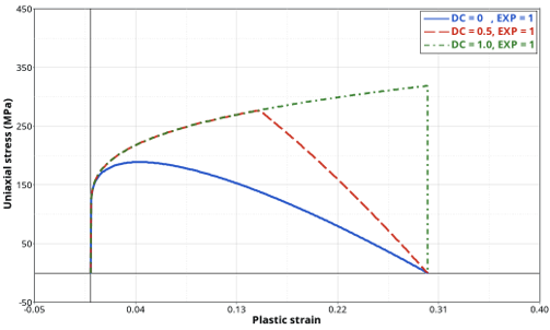

DAMAGE Flag to activate element deletion and stress softening. 2, 8
By default, damage is only used as an output variable.
Default = blank
D C MathType@MTEF@5@5@+= feaahqart1ev3aaatCvAUfeBSjuyZL2yd9gzLbvyNv2CaerbuLwBLn hiov2DGi1BTfMBaeXatLxBI9gBaerbd9wDYLwzYbItLDharqqtubsr 4rNCHbGeaGqiVu0Je9sqqrpepC0xbbL8F4rqqrFfpeea0xe9Lq=Jc9 vqaqpepm0xbba9pwe9Q8fs0=yqaqpepae9pg0FirpepeKkFr0xfr=x fr=xb9adbaqaaeGaciGaaiaabeqaamaabaabaaGcbaGaamiramaaBa aaleaacaWGdbaabeaaaaa@37B0@ Critical damage value from which the stress softening is triggered. This is valid only if DAMAGE is activated. 2, 8
0
Stress softening from the beginning (fully coupled approach)
0 < DC < 1
Stress softening from a DC value (partially coupled approach)
1
No stress softening, the element is deleted when DC = 1 (failure criterion approach)
Default = 0.95 (95 percent damage) (Real)
EXP Nonlinear exponent for stress softening. This is valid only if DAMAGE is activated. 2, 8
Default = 1.0 (Real)
