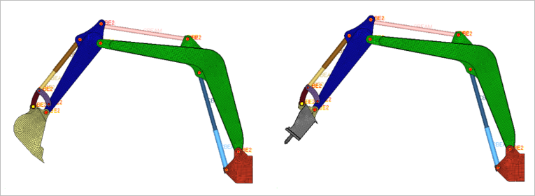

Figure 1. Two MMO Models with Excavator Arm as the Design Space and Different Excavator Buckets

Model 1 consists of an excavator bucket and Model 2 is fitted with a hammer. The operational loading involves different number and types of subcases for each model. There are three linear static subcases in Model 1 and four linear static subcases in Model 2 that simulate the possible boundary conditions encountered during operation.
The Excavator arm is selected as the design space for Topology Optimization. Each arm is modeled as a pair of PSHELL element plates. The Topology Optimization setup is two DTPL entries (1 main and 1 secondary) with Pattern Repetition in each model to replicate the design from one plate to the other. One plate is selected as the Main and the second plate is the Secondary in each model.
For excavator design, if the bucket section is intended to be versatile and can incorporate multiple tool sets (bucket, hammer, and so on), then the rest of the excavator structure should be designed to operate under a variety of different boundary conditions. Specifically, in this case, focus on designing an excavator arm that is optimized for both the bucket and hammer configurations.

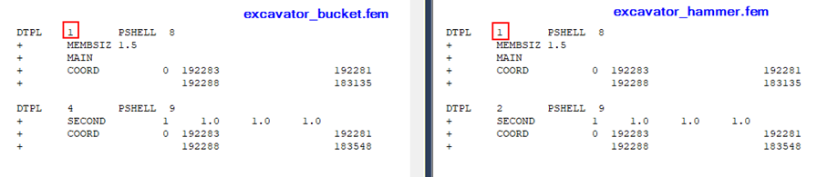

ASSIGN,MMO,bucket,excavator_bucket.fem
ASSIGN,MMO,hammer,excavator_hammer.fem

Linked design variables and domains should be identical in all respects (except for the COORD and SCALE continuation lines). The applied design parameters and manufacturing constraints should match in all models. This restriction does not apply to unlinked domains. Additionally, to facilitate internal pattern repetition, a COORD continuation line is required on the corresponding design variable or domain entry (DTPL, DSIZE, and so on). This allows identification of the location and direction of the repeated pattern across linked design domains.
The design domains are linked as:
For Model 1, the DTPL entries with ID’s 1 and 2 and for Model 2, the DTPL entries with ID’s 1 and 4 are designated MAIN and corresponding SECOND pairs. This is used for pattern repetition within each model (NOT across models) and is not related to MMO. Such pattern repetition within each model is, of course, optional and depends on the use-case. In the current model, the two plates of the design space is required to have matching patterns so it can be manufactured easily.
Figure 2. Bulk Data setup
The COORD continuation line allows the identification of the anchor point and mapping of the design among multiple models. This continuation line is mandatory. If individual pattern repletion is not setup (via MAIN/SECOND) in all models, you are required to specify the COORD continuation line independent of the MAIN/SECOND continuation lines.

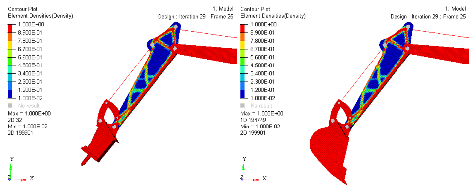

Results
Figure 4. Mapped Design Domain Result for Multiple Models with Different Configurations. final designs are identical
