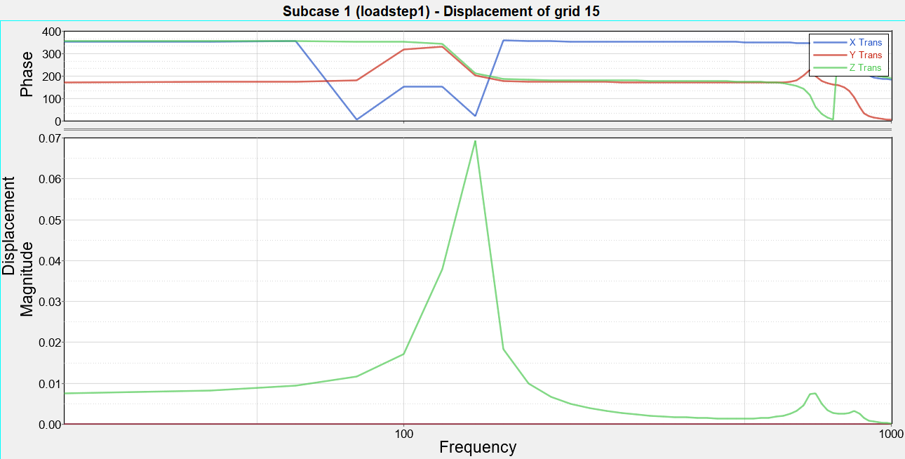

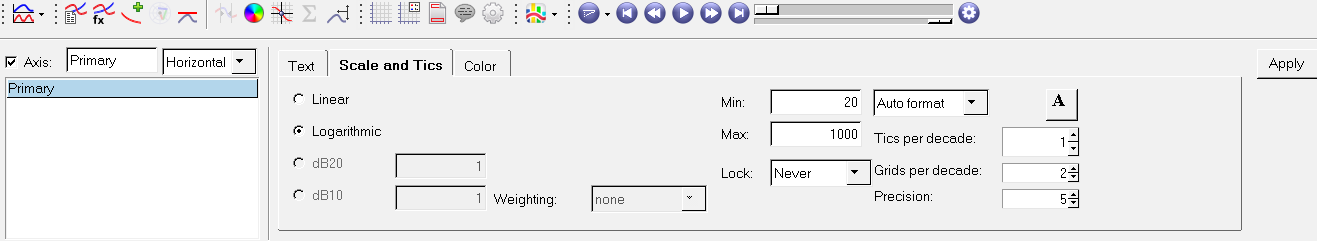

    Two graphs per page and a total of three pages are displayed in HyperGraph. The graph title shows Subcase 1 (subcase 1) - Displacement of grid 15 on page 1.
  7. Click the Axis toolbar icon annotateAxes-24. Select Logarithmic option and use the parameters shown below to make logarithmic plots of the results.
    rad_logarithmic
    Figure 5.
    There are two sets of results on this page. The top graph shows Phase Angle verses Frequency (log). The bottom graph shows Magnitude verses Frequency (log) (see figure) for Displacement of grid 15.
    rd2010_results15
    Figure 6. Frequency response of node 15

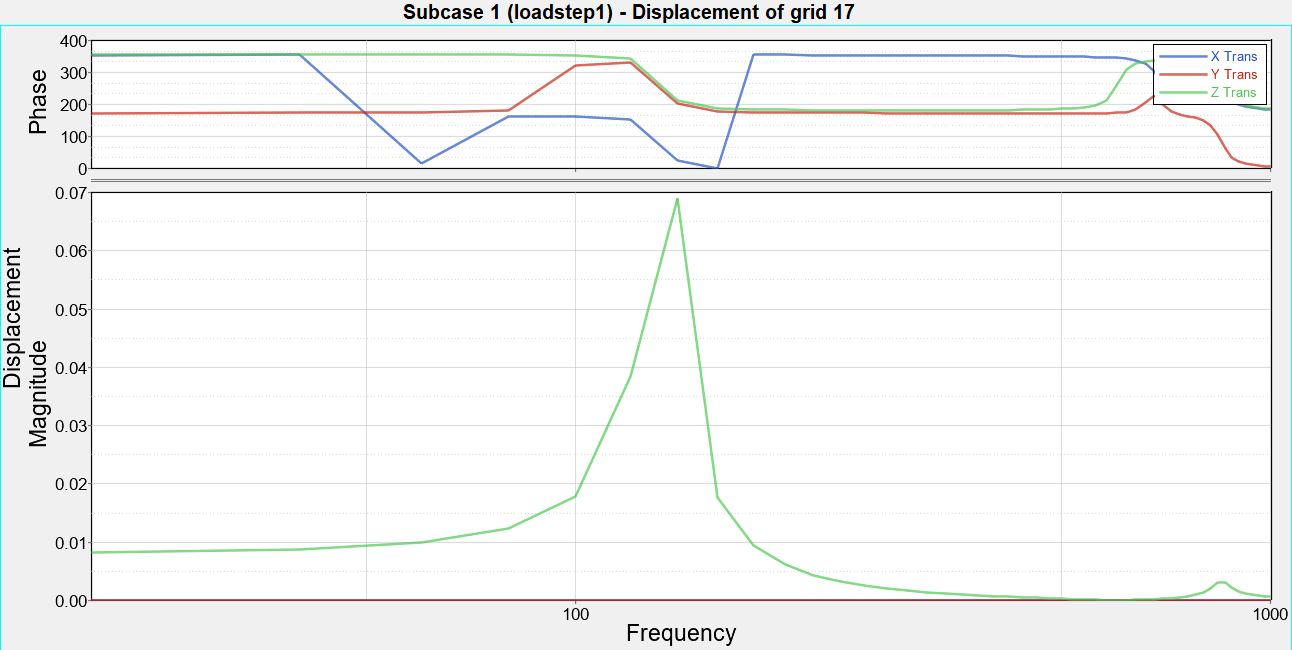

  8. Directly underneath the blue graph border, click the Next Page icon pageNext-24.
    Page 2 displays, which shows Subcase 1 (subcase1) - Displacement of grid 17.
    rd2010_results17
    Figure 7. Frequency Response of Node 17
