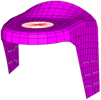

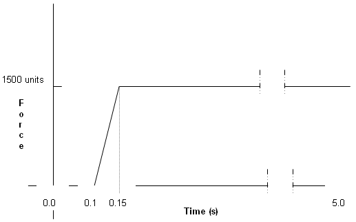

The bracket is constrained at the bottom of the two legs. Transient dynamic loads are to be applied at the grid points of the top, flat surface of the bracket around the hole in the negative z-direction. The time history of the loading is shown in Figure 2. The modal transient analysis is run for a total time of 4 seconds with the time being divided into 800 increments (that is time step is 0.005). Modal damping has been defined as 2% critical damping for all the modes. Modes up to 1000 Hz have been considered. A concentrated mass element is defined at the center of the spider and z-displacements are monitored at the concentrated mass at the center of this hole.
time_history
Figure 2. Time History of Applied Loading

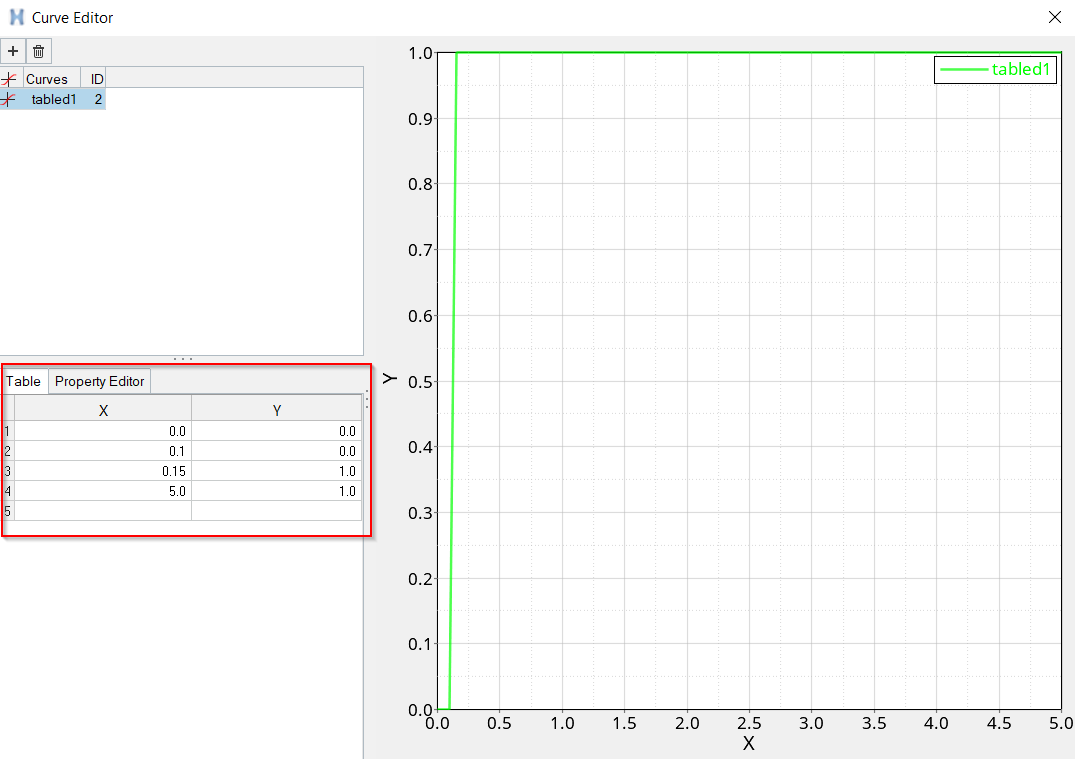

Create a TABLED1 Curve
  1. In the Model Browser, right-click and select Create > Curve.
  2. For Name, enter tabled1.
  3. In the Curve Editor window, enter the values shown in Figure 3.
    Figure 3. Table Showing Time History of Loading
  4. Close the Curve Editor.
  5. In Curves, select tabled1.
  6. Click Color and select a color from the color palette.
  7. For Card Image, select TABLED1 from the drop-down menu.
    The curve TABLED1 that defines the time history of the loading has been created.

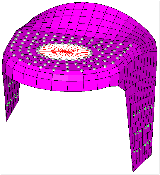

To define forces on the top surface of the bracket.
  1. In the Model Browser, right-click and select Create > Load Collector.
  2. For Name, enter darea.
  3. Click Color and select a color from the color palette.
  4. For Card Image, select NONE.
  5. Click BCs > Create > Constraints to open the Constraints panel.
  6. Click nodes > by sets.
    Two sets are displayed.
  7. Select force and click select.
    The nodes that belong to the set force get selected.
    rd2030_pic3
    Figure 4.
  8. Uncheck all degrees of freedom (dof), except dof3 by clicking the box next to each, indicating that dof3 is the only active degree of freedom.
  9. For dof3, enter a value of -1500.
  10. For load types=, select DAREA.
  11. Click create.
    This creates a force of 1500 units applied to the selected nodes in the negative z direction.

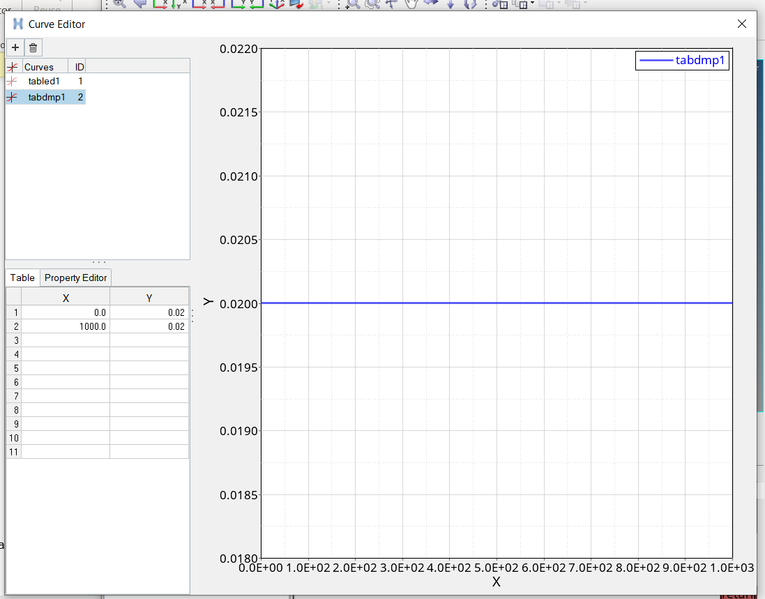

Create a TABDMP1 Curve
The modal damping table to define damping as a tabular function of frequency.
  2. For Name, enter tabdmp1.
  3. In the Curve Editor window, enter the values shown in Figure 5.
    Figure 5.
  5. In Curves, select tabdmp1.
  7. For Card Image, select TABDMP1 from the drop-down list.
  8. For TYPE, switch to CRIT to specify critical damping.
  9. Populate the frequency and damping values for frequencies 0 and 1000 Hz and damping to be 0.02. This provides a table of damping values for the frequency range of interest.

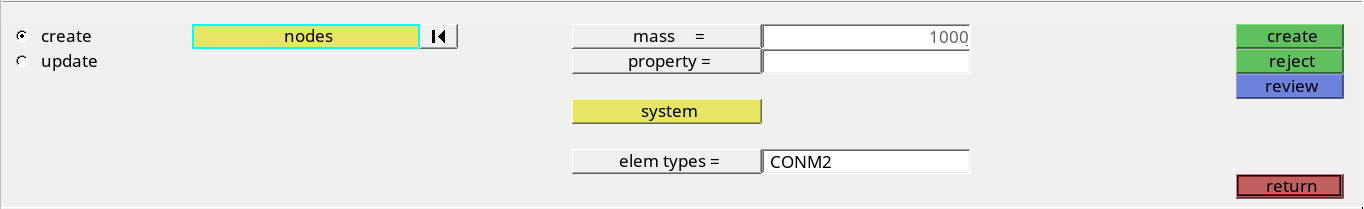

Apply Concentrated Mass
  1. Select the 1D panel radio button.
  2. On the panel, select masses.
  3. Select nodes > by id.
  4. In the dialog, enter 395 for the node ID.
  5. For mass, enter 1000.
    Figure 6.
  6. Click create and then click return.

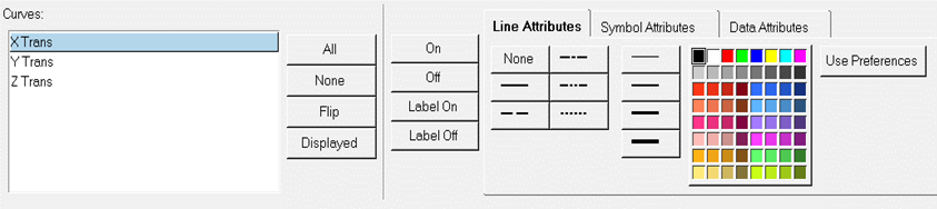

  4. On the Visualization toolbar, click palette-24 to open the Curves Attributes panel.
  5. Under Curves, individually select the X Trans and Y Trans curves and click Off.
    rd2030_pic6
    Figure 8.
    The X Trans and Y Trans curves are turned off.

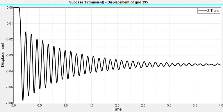

  6. Click options-24 to fit the y-axis (that is Z displacement) of node 395.
  7. You can change the color and/or line attributes of the curve, if you wish.
As can be observed from the above image, the displacements of node 395 are in the negative z-direction as the loading is in the -z direction too. The displacements eventually damp out due to the structural damping present in the model.
rd2030_pic7
Figure 9. Z-displacement time history of the concentrated mass. at center of spider for direct transient dynamic analysis
