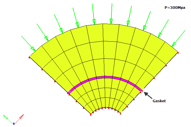

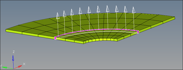

Figure 1 illustrates the structural model used for this tutorial: A 1mm thick cylindrical gasket is sandwiched between two co-axial steel cylindrical tubes. The outer cylinder is subjected to a pressure of 300 MPa on the outer surface as shown. Using symmetry boundary conditions, only a quarter of the geometry has been modeled. The gasket is connected to the inner and outer cylinders using contact.
rd2090_gasket_model
Figure 1. Model and Loading Description

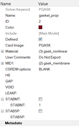

Create the Gasket Property
  1. In the Model Browser, right-click and select Create > Property.
  2. For Name, enter gasket_prop.
  3. Click Color and select a color from the color palette.
  4. For Card Image, select PGASK from the drop-down menu and click Yes to confirm.
  5. For Material, click Unspecified > Material.
  6. In the Select Material dialog, select gask_nonlin from the list of materials and click OK to complete the selection.
  7. For MID1, select the gask_membrane material.
  8. For STABMT field, select 1 to define some stabilization stiffness.
    OS_1360_01
  9. Next, assign this property to the gasket component. Click on the component GASKET in the Model Browser.
  10. For Property, select gasket_prop property.

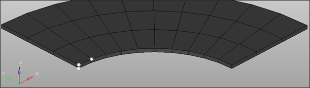

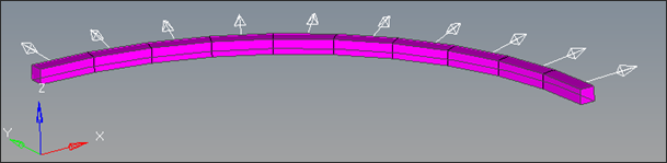

    The normals of the gasket elements are not in the thickness direction, but in the Z-direction, as shown below.
    rd2090_gasket1
    Figure 3.
    So, adjusting the normals needs to be in thickness direction.
  4. Display only the GASKET component.
  5. Click on by nodes on bottom face and select the GASKET component.
  6. For choosing the face nodes, click on nodes and select three nodes on a face of any gasket element in the thickness direction and click adjust normals.
    The normals are now adjusted to be in thickness direction of gasket, as shown below.

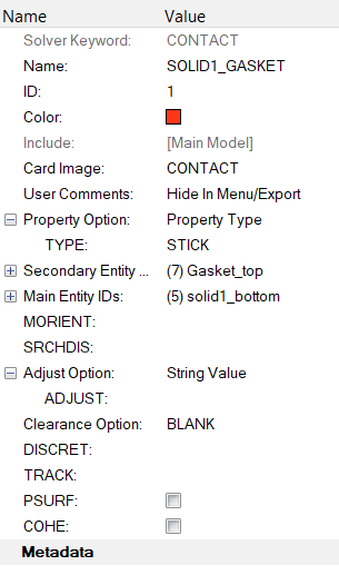

Now, an interface between the top cylinder and gasket are created.
  1. In the Model Browser, right-click and select Create > Contact.
  2. For Name, enter SOLID1_GASKET.
  4. For Card Image, select CONTACT from the drop-down menu.
  5. For Main Entity IDs, select the SOLID1_bottom surface.
  6. For Secondary Entity IDs, select the GASKET_top surface.
  7. For TYPE, select STICK from the drop-down menu.
    OS_1360_02
    Figure 6.

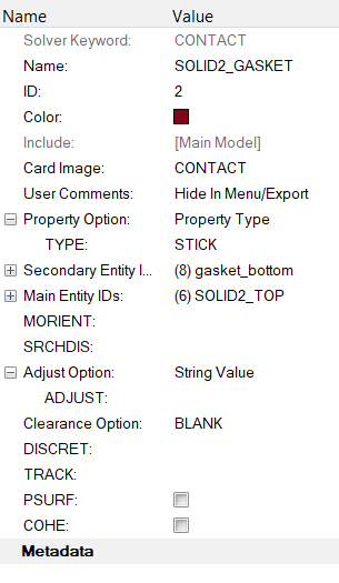

  8. In the Model Browser, right-click and select Create > Contact.
  9. For Name, enter SOLID2_GASKET.
  10. Click Color and select a color from the color palette.
  11. For Card Image, select CONTACT from the drop-down menu.
  12. For Main Entity IDs, select the SOLID2_top surface.
  13. For Secondary Entity IDs, select the GASKET_bottom surface.
  14. For TYPE, select STICK from the drop-down menu.
  15. Click review to review the interface.
    OS_1360_03

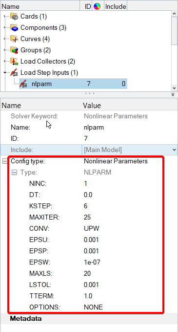

Define Nonlinear Implicit Parameters
  1. In the Model Browser, right-click and select Create > Load Step Inputs.
  2. For Name, enter NLPARM.
  3. For Config type, select Nonlinear Parameters.
    The default for Type is NLPARM.
  4. For NINC, enter 1.
    Figure 8. NLPARM Definition
  5. Use the values shown in Figure 8.
    For details on the nonlinear implicit parameters, refer to the online help.

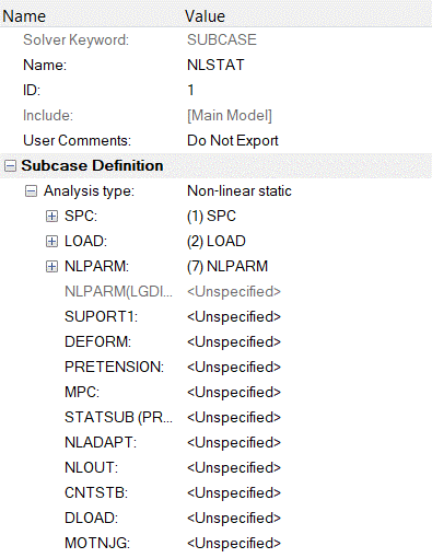

Create NLSTAT Load Step
  1. In the Model Browser, right-click and select Create > Load Step.
  2. For Name, enter NLSTAT.
  4. Click Analysis type and select Nonlinear static from the drop-down menu.
  5. For SPC, select SPC from the list of load collectors.
  6. For LOAD, select LOAD from the list of load collectors.
  7. For NLPARM, select NLPARM from the list of load step inputs.
    OS_1360_04
    Figure 9.

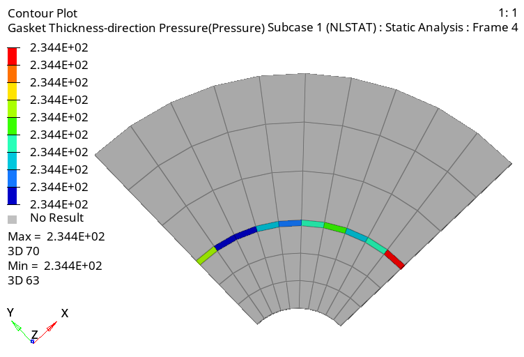

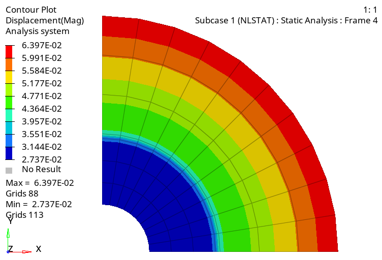

View the Results
In HyperView, plot the displacement and contact pressure contours at the end of the analysis.
rd2090_displacement
Figure 11. Contour of Displacements in Cylinders and Gasket Subject to Loading
rd2090_gasket_thick
Figure 12. Contour of Gasket Thickness Direction Pressure

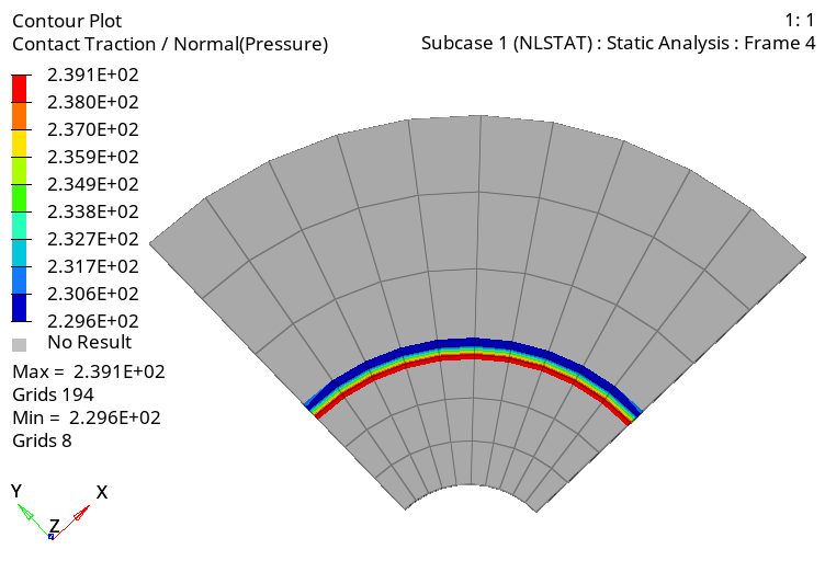

rd2090_contact_pressure
Figure 13. Contour of Contact Pressure
