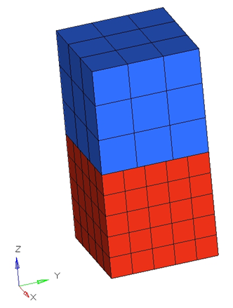

Figure 1. Illustration of the Model

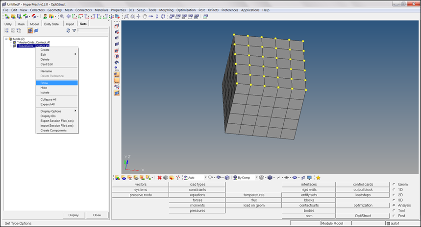

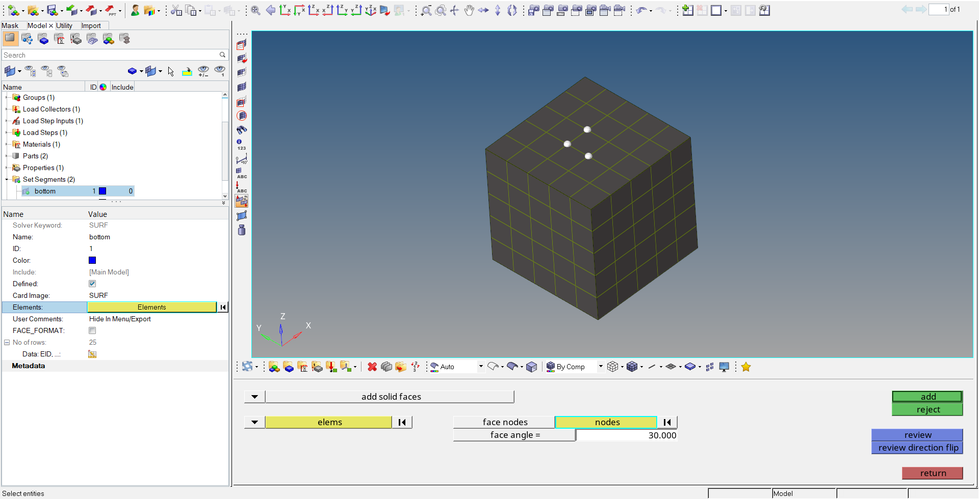

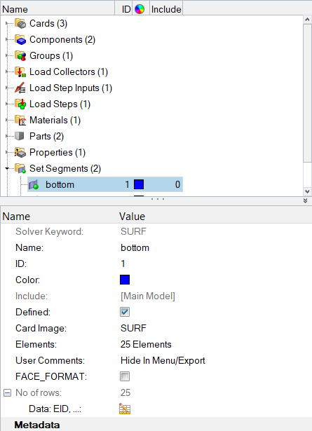

Create Set Segments

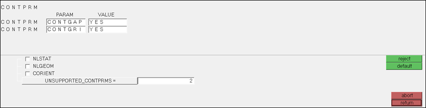

Create the Contact Interface

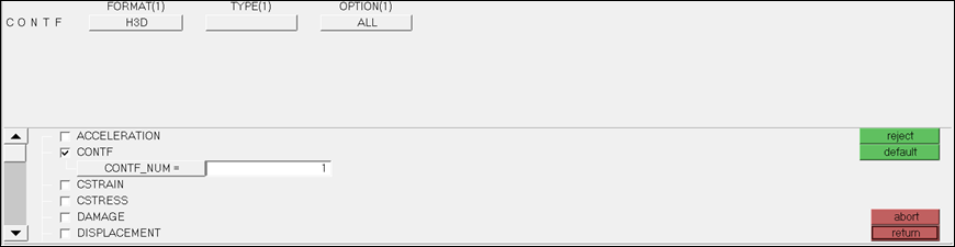

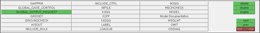

Create Output Requests

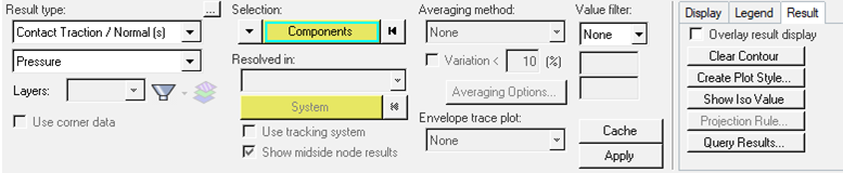

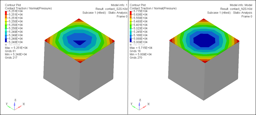

Displacements, Element Stresses, Contact Force, Contact Deformation, Contact Status and Contact Traction are calculated and can be plotted using the Contour panel in HyperView. Only compare the Contact Traction between the N2S and the S2S run.
Compare the Contact Traction

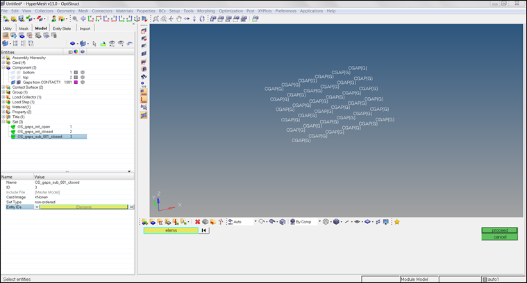

Review the Internally Created CGAPC Elements
Review the Grids

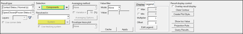

Review the Contact Status
Figure 16. Review the Contact Status in HyperView as a Contour Plot
