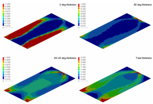

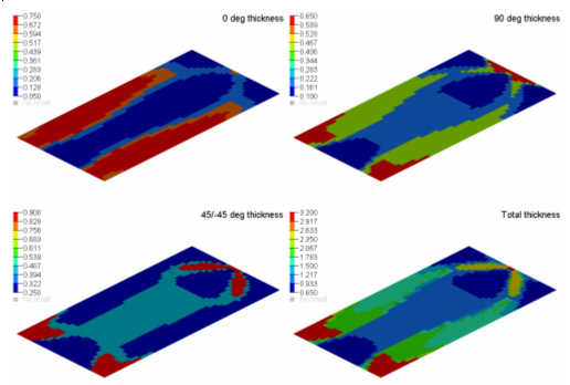

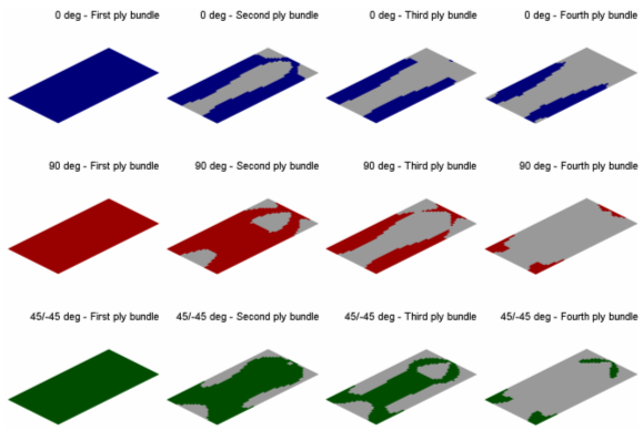

Free-sizing (Parameter) Optimization
DSIZE 1 PCOMP 1
+ COMP LAMTHK 3.2
+ COMP PLYPCT ALL 0.10
+ COMP BALANCE 45.0 -45.0
Figure 1. Ply Bundles After Ply-based Interpretation
Figure 2. Thicknesses After Free-sizing Optimization
Figure 3. Thicknesses After Ply-based Interpretation

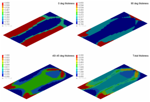

Once a concept design has been established, additional performance measures should be introduced. In this example, you are changing the formulation to minimize the volume while constraining the maximum principal stress in every ply. Also, the composite manufacturing constraints from the previous stage are preserved and transferred to the DCOMP card.
Figure 4. Thicknesses After Ply-based Sizing Optimization
