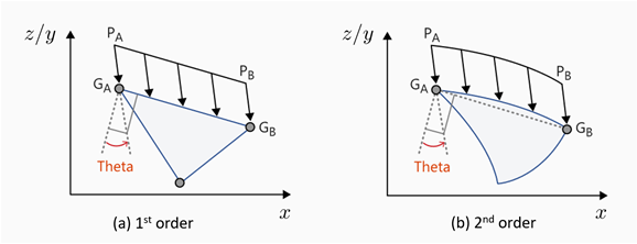

- THETA is
measured counterclockwise from the inward normal of the straight line
between GA and GB, to the vector of
the applied load (Figure 1). Positive
pressure is in the direction of inward normal to the line segment.
Figure 1. Pressure Load Definition on Plane Elements
