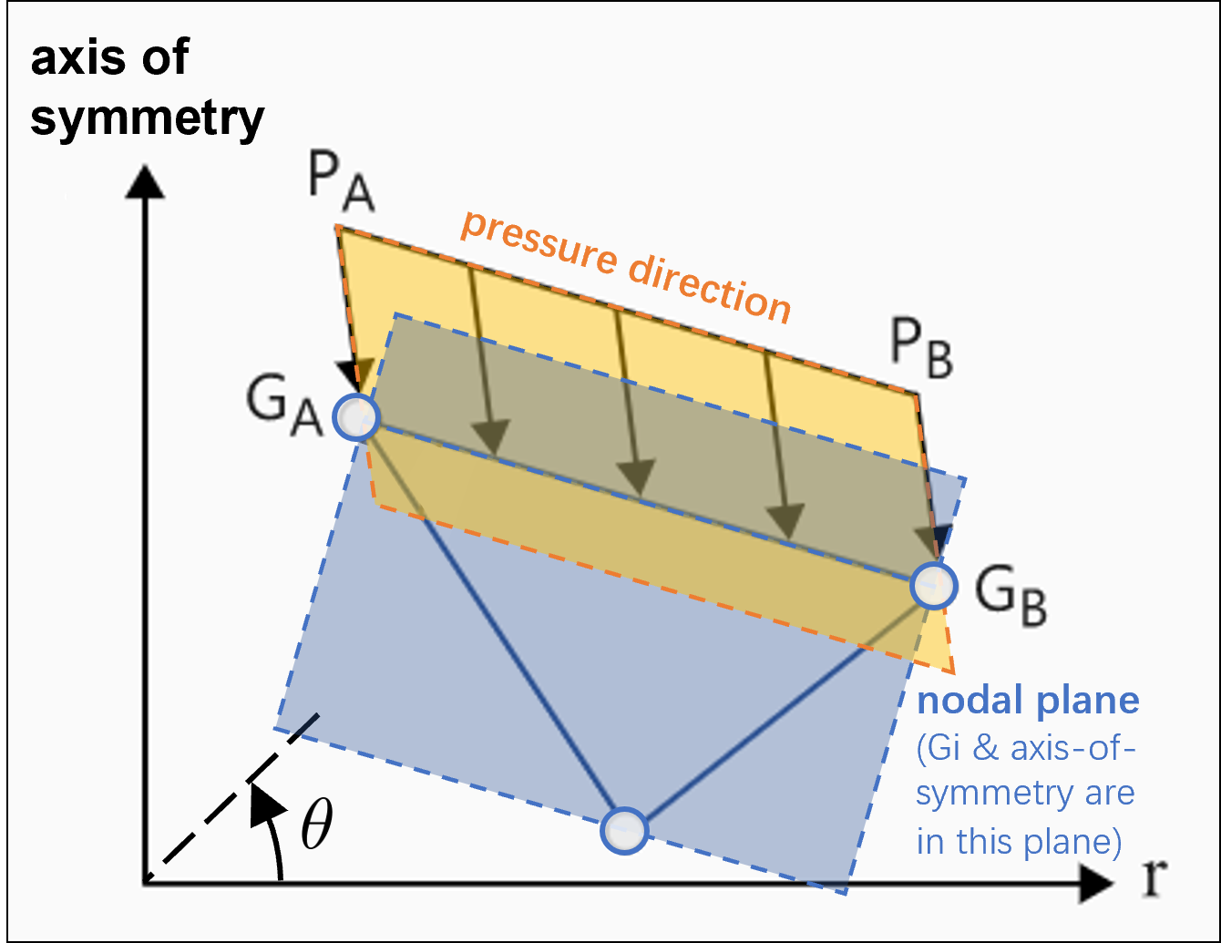

- The surface traction is assumed to
vary linearly along the element side between GA and
GB.
Figure 1. PLOADXG Definition - The surface traction is input as force per unit area.
