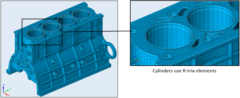

Figure 2. Boundary Conditions in the Cylinders

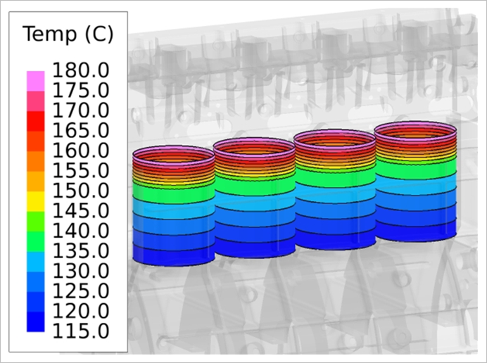

Figure 3. Temperature Results

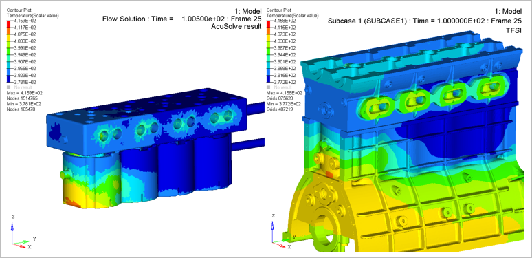

Figure 5. Temperature Results in the Water Jacket and Engine Block
Pressure drop and the flow uniformity in the fluid domain.

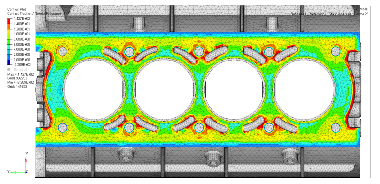

Figure 8. Contact Pressure Results

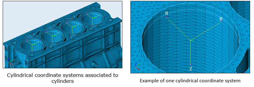

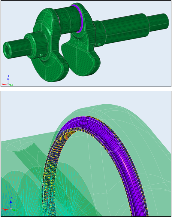

Figure 9.
Figure 10. Meshing and Coordinate System
Use the domain decomposition method to reduce time for calculation, especially for the largest models like the model used to calculate bore deformation.
Imprint functionalities available in SimLab can be used to have coincident meshes in contact areas.

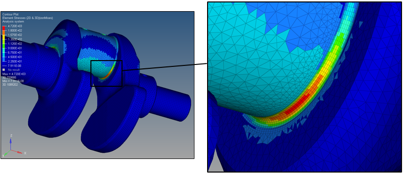

Figure 13. von Mises Stress Results
