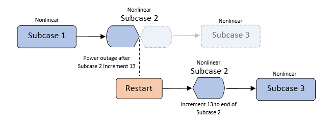

Example:
If a 3-subcase model with RESTARTW was interrupted due to power outage during the solution of subcase 2, after the 13th increment, the following can be added to the model to restart it.RESTARTR = originaljob_sub2_inc0013This will restart the model from the interruption point (end of increment 13), and the load history of Subcase 2 from increment 13 will be continued.

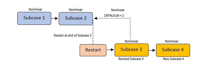

Example:
If a 2-subcase model with RESTARTW completed successfully, but now you want to add new subcases 3 and 4 for continuation of the loading path. The new subcases 3 and 4 are in the same chain of subcase continuation.
If the final increment of subcase 2 is increment 21, use:RESTARTR = originaljob_sub2_inc0021This will restart the model from the end of subcase 2, and new subcase 3 and new subcase 4 will be run.

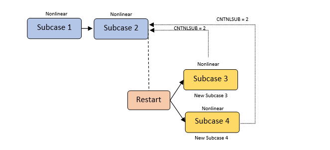

Figure 2. Example: Append New Subcases After a Successful RunExample:
If a 2-subcase model with RESTARTW completed successfully, but now you want to add new subcases 3 and 4 for continuation of the loading path. The new subcases 3 and 4 are in different chains of subcase continuation, but both continue from subcase 2.

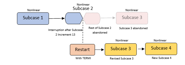

Example:
If a 3-subcase model with RESTARTW was interrupted after the 13th increment of Subcase 2. If you want to restart the run, and discard the rest of the load history of subcase 2, and its subsequent subcase 3, from the restart point, use the TERMI option.
If subcase 2 terminated at increment 13, use:RESTARTR = TERMI,originaljob_sub2_inc0013This will abandon the remaining load history from the restarting point for subcase 2, and you can append revised subcase 3 and new subcase 4 to the restarting point for a revised loading path.
When TERMI is specified, OptiStruct will abandon the remaining load history from the restarting point (original run) and append new loading history continuing from the restarting point in the restart run.
Figure 4. Example: Abandon Remainder of Subcase 2 and its Subsequent and Appending New SubcasesFor the 3-subcase example, assuming the load histories (in total time) are:
1st Subcase → [0 – 1s], 2nd Subcase → [1 – 2s] and 3rd Subcase → [2 – 3s], the revised 3rd Subcase → [1.3 - 2.3s] and the new 4th Subcase → [2.3 – 3.3s].
If the run gets terminated at 1.3s of 2nd subcase, with TERMI, the remaining load history from [1.3s – 3s] for subcases 2 and 3 will be abandoned. The revised subcase 3 and new subcase 4 will now append to the restarting point (1.3s at subcase 2) for a revised loading path.

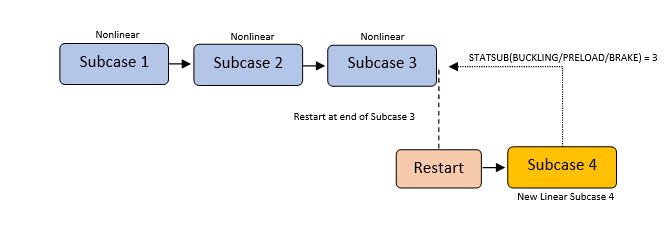

Example:
If a 3-subcase model with RESTARTW completed successfully, but now you want to add a new subcase 4, which is a Linear subcase with STATSUB(BUCKLING/PRELOAD/BRAKE).
If the final increment of subcase 3 is increment 25, use:RESTARTR = originaljob_sub3_inc0025
Figure 5. Example: Append a Linear Subcase with STATSUBThis will restart the model from the end of subcase 3 (beginning of subcase 4) and the new subcase 4 (linear subcase) will be run.Note: In this case, the STATSUB entry in linear subcase 4 should point to the final nonlinear subcase in the chain (which is subcase 3 for this example).
